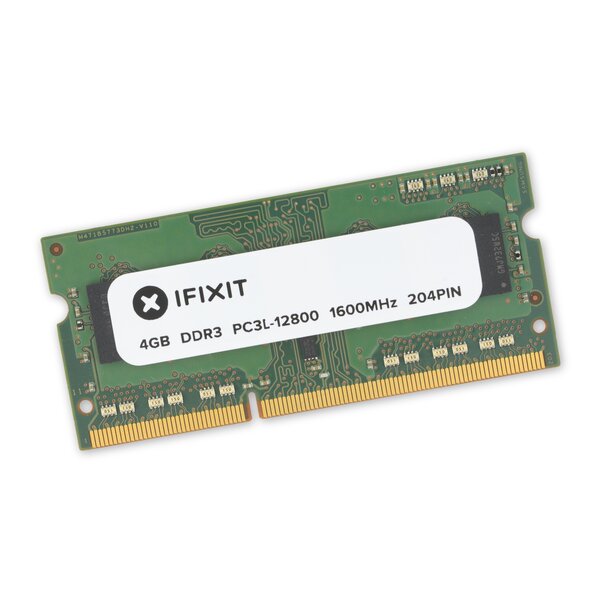

If your manual says the beep code corresponds to a memory error of some sort, then open up your computer and re-seat the RAM—that is, try removing each stick and re-inserting it, making sure it clicks into place. (This can take a bit of force, especially on desktop computers, so don’t be afraid to really push it in there.) If you aren’t sure how to get into your PC or where the RAM is, we have repair guides for laptops and repair guides for desktop PCs of all stripes that will show you the way.
If re-seating the RAM doesn’t work, you can also try removing one of the sticks and seeing if the computer boots with just one. If you can boot with one stick, then your other stick (or slot) may be bad. Thankfully, it’s pretty easy to buy replacement RAM online—we even carry some in our parts store, so search for your specific laptop or desktop to find a compatible replacement stick.
