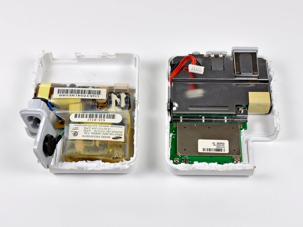

Inside were two separate PCBs. On the left was the power supply for the base station, on the right the AirPort Express card and sound board. Note the jagged edges around the case perimeter, evidence of the destruction needed to open it.
Andrew handled the repair from this point. He immediately focused on the power supply, as none of the AirPorts were powering on. After a bit of unscrewing and unwrapping, he quickly realized the problem: both units contained burnt components in the same exact part of the power supply, rendering them useless.
Turns out the board was almost completely burned through near an inductor on the top side of the board. On other side there were two SMT resistors that also bit the bullet. It was not a pretty sight.
As Andrew found out, fixing the power board proved to be a futile exercise. The inductor had continuity between its contact points, and it was assumed to be somewhat functional. He soldered new resistors on the other side of the board, but no amount of manipulation would fix the board. So he tossed it aside and focused on providing an alternate source of power to the AirPort card inside the unit.
Some astute readers may have noticed the output power ratings on the Samsung sticker Andrew removed from the power supply. This crucial piece of information allowed him to analyze the problem further. Apple usually doesn’t give out carrots like these, so they must have thought that nobody would be crazy enough to open up an AirPort Express Base Station. Silly Apple.
Written on the power supply in all caps: OUTPUT: “+5V @ 0.7A,” and “+3.3V @ 1.21A” — score!

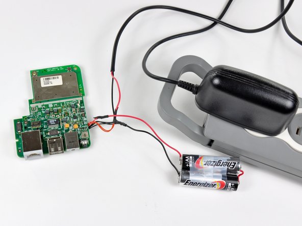

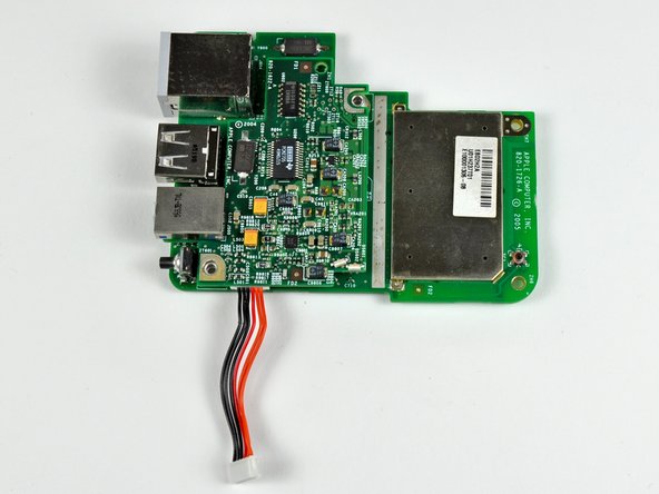

Since there was one cable connecting the two boards together, Andrew had little trouble figuring out where the power was coming in. The tricky part was to figure out which wire provided the 3.3V and which the 5V input. Kind of like “do I cut the blue wire or the red wire” on a bomb, but with less explosive potential results.
The second problem of the day was finding a ~3V power supply. We had a generic 5V, 1A phone charger laying around, but nothing near 3V. So Andrew did what any other self-respecting enginerd would do: solder two AA batteries together. A short while later, he had mockup #1 emitting an orange light.
Great news! Except not really. Even though the AirPort Express Base Station powered on, it would not retain custom settings once we tried to set it up properly. The second unit exhibited the same exact problem. No amount of tinkering by either Andrew or yours truly would alleviate the problem, so we abandoned the project for the remainder of the day.
That night I got a text message from my persistent co-worker, who took the project home to work on it in his own time. It read: “I guessed wrong. Swapped the wires and it works!!!” We had discussed swapping wires earlier in the day, but figured that the unit wouldn’t power on at all, and that something else was the problem. Sometimes we shouldn’t overthink things and just do them.
So here is the correct wiring setup:
- Black wires: ground. All three should be connected to the two ground wires from the power supplies.
- Red wire (middle): 5V, 0.7A power input.
- Orange wires (two on the right): 3.3V, 1.21A power input.
If you have trouble discerning the wires in the image below, check it out in full-res.

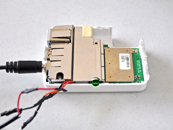

Andrew wanted to do things proper the second time around — no AA battery funny business anymore — so he went to Radio Shack and acquired a 3V/4.5V/6V/7.5V/9V/12V switchable power supply. The final setup, which I’m listening to while typing this, looks like this:
R-Shack wanted a steep $20 dollars for that fancy power supply, but convenience is king. For our other soon-to-be-fixed units, we found some great cheapo power supplies on Ebay that should work just fine. We won’t know until a couple of weeks from now, so we’ll keep on rocking with the R-Shack power source for now.
Final power supplies that we used for our gizmo was an R-Shack 3V, 1A and a 5V, 1A power supply. We also put the AirPort card back into its half of the plastic shell. This is how it looks like when in use:
