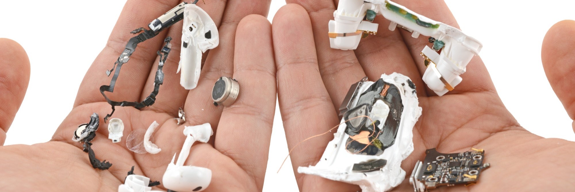

The first time we took apart a pair of AirPods, we literally bled on the teardown table, trying to figure out how to slice our way inside. Apple locked away the buds’ tiny lithium batteries under layers of glue, making them essentially disposable. We gave them a 0/10 repairability score.

Every AirPods teardown comes down to one question: can you replace the battery this time?
The short answer is no. The long answer is also no, just with more frustration. Opening up a bud requires heating it to just the right temperature and carefully prying it apart with sharp tools, often leaving permanent scars on the housing. Inside, the coin-cell battery is glued down so firmly that only heat, tweezers, and a lot of luck will free it.
Even then, the design forces critical flex cables through solder points and glued channels that make reassembly nearly impossible. One wrong move and the microphone array or ANC hardware is toast. After hours of careful work, we ended up with shards of plastic, torn ribbon cables, and destroyed drivers. Not exactly a success story.

We wish we could say otherwise, but these buds are still disposable by design. Sure, the batteries are technically removable with specialized tools and a willingness to destroy the housing. But for any normal user (or even most repair shops) the process is a non-starter. And even if you managed to swap a cell, sealing the bud back up is another battle.
