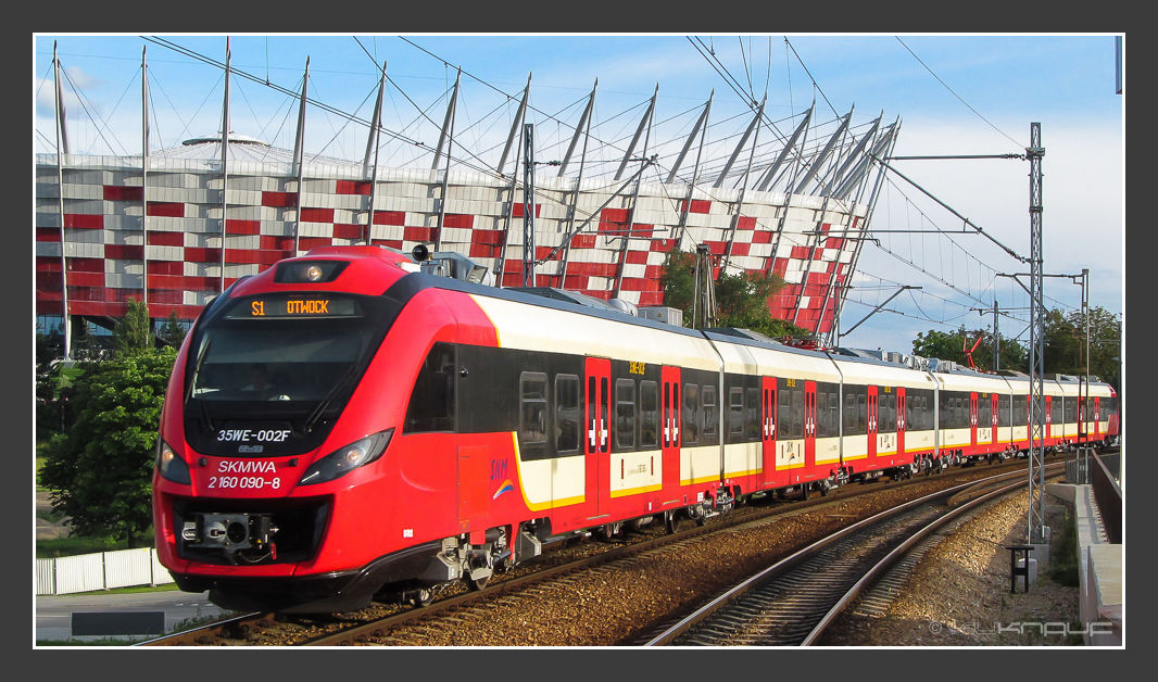

A Newag “Impuls” train passes the National Stadium Warsaw. Photo via Schnitzel_bank on Flickr.

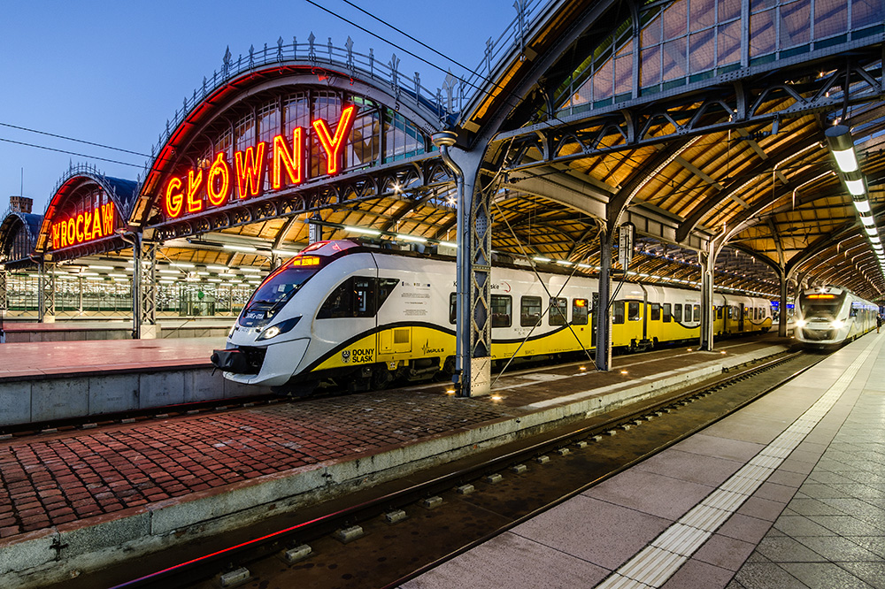

More Newag “Impuls” trains in Wroclaw, via M.M. Czarnecki on Flickr.
