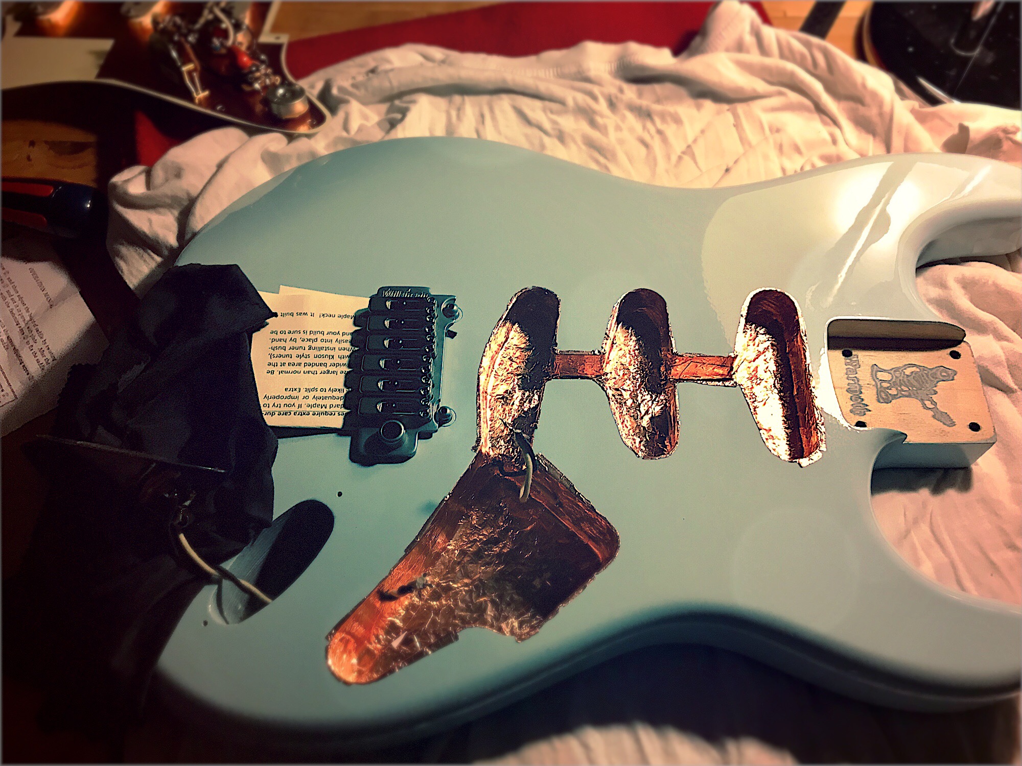

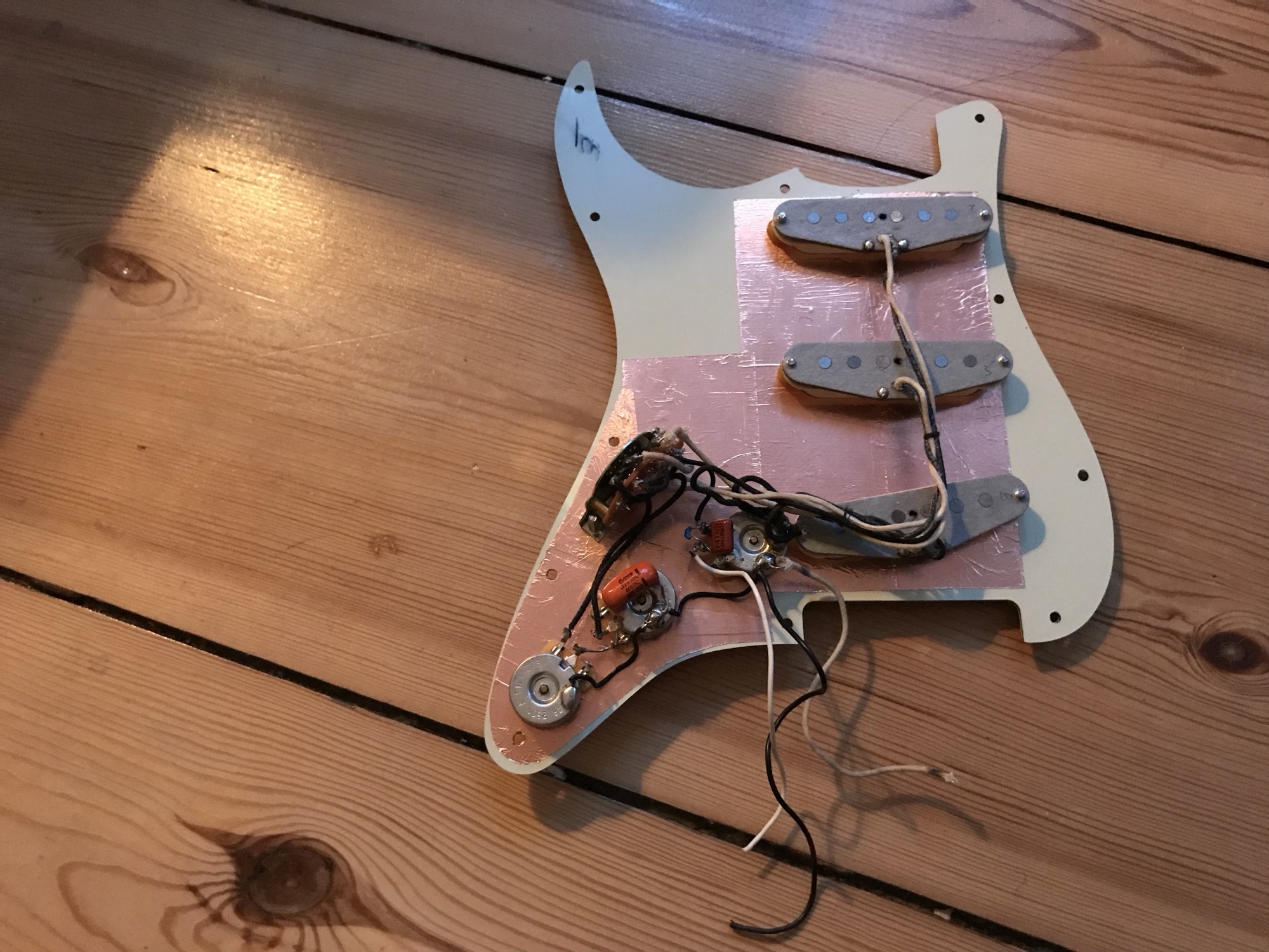

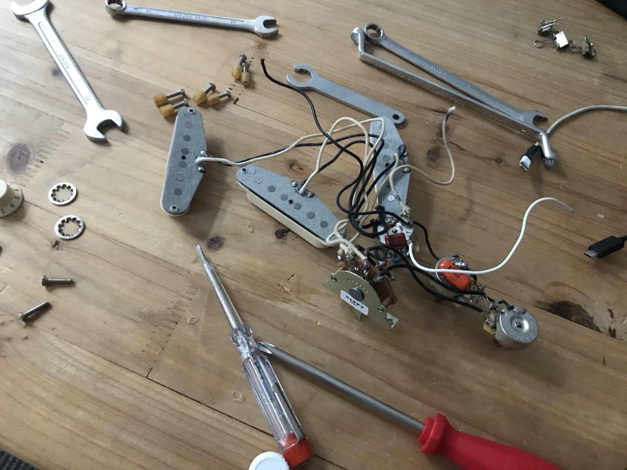

The first important tip for guitar wiring is to protect the guitar’s finish. The wiring from the pickup etc. usually runs through a tunnel in the wood to the output jack, which is too big for the tunnel. After the initial wiring-up, then, everything has to be worked on in-situ, which means laying the pick-guard face-down on the guitar’s surface. I use cardboard to protect the paint from scratches, and to stop solder from blobbing onto it.
Because the pick-guard-mounted components are anchored to the jack, you also don’t have much wiggle-room, especially as guitar-wiring tends to be kept short to avoid picking up interference. Which brings us to the next main point—everything on a guitar is grounded. There will even be a wire running from the bridge (which itself touches the strings) to ground. Otherwise, you’re going to get hum.
The soldering itself is straightforward, once you have decided on a wiring scheme, with one exception. You will be soldering wires to some big hunks of metal, which are heatsinks that wick away heat. This is bad news for potentiometers, which are easily damaged by overheating.
The trick is to use more power. Guitar mod guru Dirk Wacker recommends using a 30-watt iron for most guitar work, with a 60-watt iron for soldering pots. The extra power heats a spot on the pot faster, allowing you to solder, and get out quickly. With lower power, the pot’s metal casing conducts the heat away before it can get up to temperature.

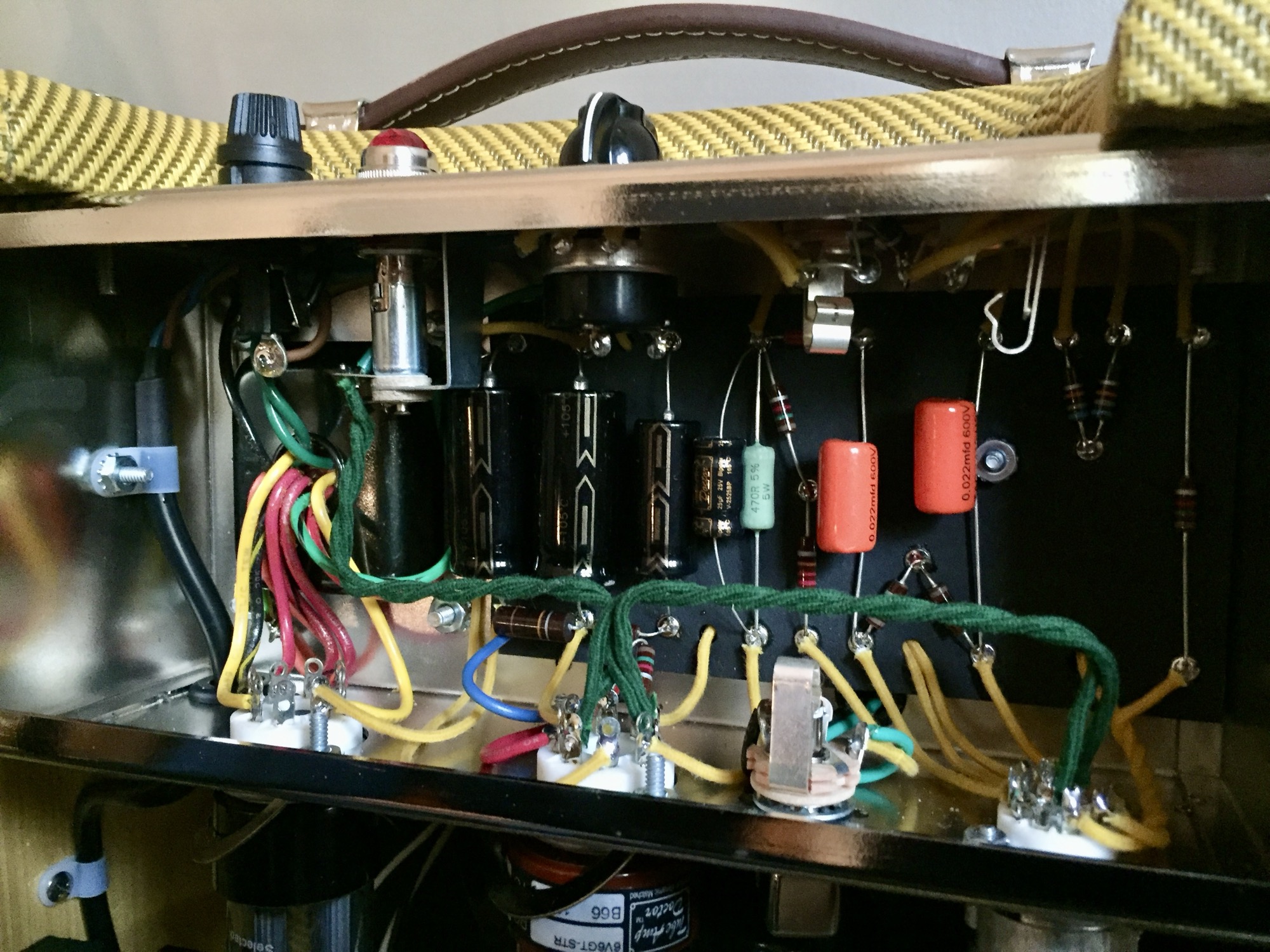

Other than that, working inside an amp is even easier than working inside a guitar, mostly because you have more space. If it’s a tube amp, or a solid-state-but-not–yet-a-computer amp, then it will likely have been put together by hand, and can easily be repaired by your hand.
One other important note. You may notice that the wiring in that vintage tube amp is neat. It’s not just for aesthetics. Keeping wires short minimizes the possibility of picking up electromagnetic interference. You should also pay attention to any twisted pairs of wires. If you run power and ground wires parallel to each other, then they can turn into a kind of loop antenna, which picks up magnetic noise. Twisting them helps to cancel out any picked-up interference, as well as reducing the space for it to occur in the first place.
Do not twist your signal wires together though, because the signal can induce a current in the ground which can lead to hum and feedback.

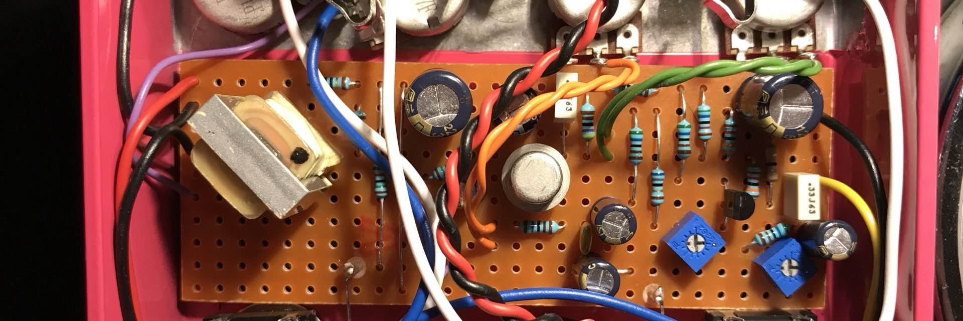

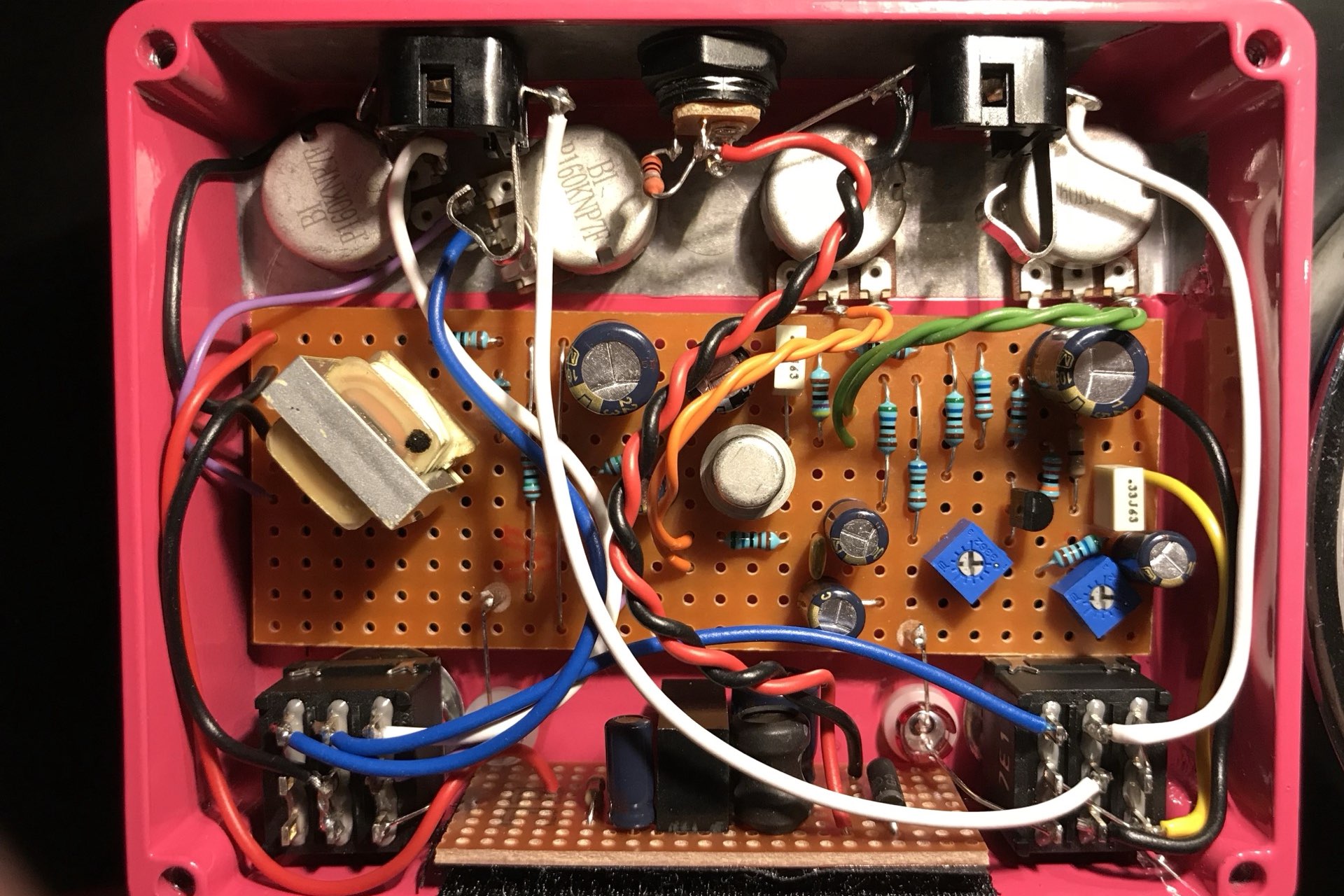

You can repair, mod, or build your own guitar pedals.

And it’s not just cables that can be modded. If you play the guitar, then there’s a whole lot of modding that can be done just by swapping a few wires, or changing the values of capacitors. Let’s get into the esoteric world of circuit modding.

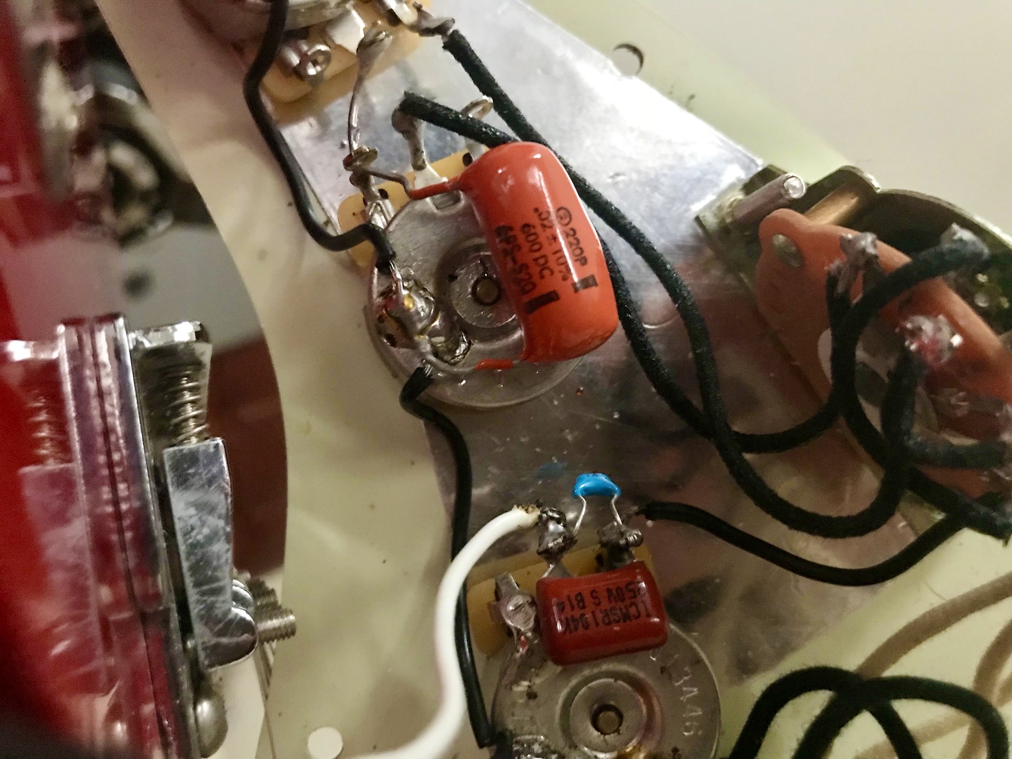

My favorite is what has come to be called “50s wiring.” In a guitar circuit, the volume and tone potentiometers are identical. They’re used as variable resistors. In the case of volume, part of the signal is sent to ground, and therefore discarded. For tone, the pot sends part of the signal to ground. The cut-off point of the high frequencies that are bled off depends on the value of the resistor.
There are several ways to connect the volume and tone pots together, and this is the heart of “50s wiring,” as compared to “”60s wiring,” and “modern wiring.”
In modern wiring, the output of the tone pot is connected to the input of the volume pot. For the full explanation see this excellent article by Dirk Wacker, but the short version is that this causes the tone to get “darker” (less treble) when you turn down the volume.
In 50s wiring, you connect the tone pot’s output to the volume pot’s output instead of its input. This prevents the volume pot from affecting the tone, but it also makes the guitar sound clearer overall. I use this on my guitar. And if you’re feeling fancy, you could add a switch to swap wiring schemes on the fly.
Guitar pickups can be wired many different ways.
Another easy mod is to add a bass-cut control. The Fender Stratocaster (as seen in several of the pictures of my guitar in this article) has three knobs. Normally one of the pots is for volume, and the other two control the tone of the three pickups, in two groups.
With the bass roll-off, you rewire one of those tone controls, using the capacitor to remove bass frequencies. In conjunction with the regular tone knob you get way more control over the sound. And cutting the bass lets you finesse the amount of distortion you get from a cranked amp, with a minimal effect on the volume.

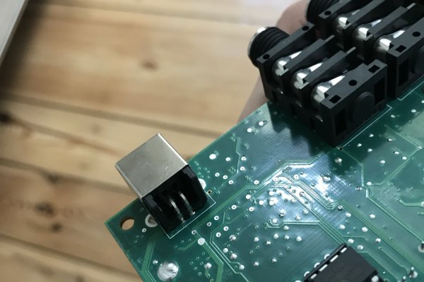

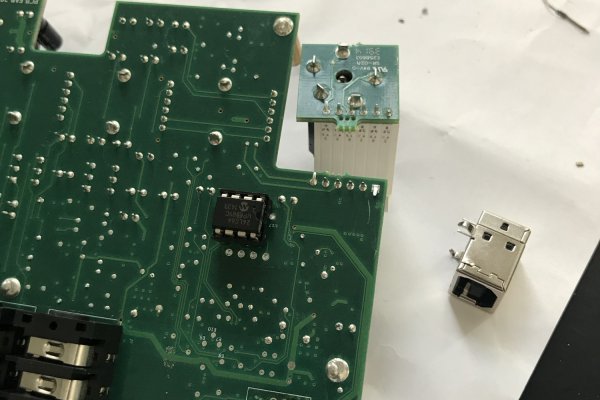

One very useful skill is being able to replace a USB socket. These can be a weak point on music gear, nowhere near as robust as a 1/4-inch jack (originally designed for being endlessly replugged by telephone operators to route calls).
A well-designed circuit, like that of the Teenage Engineering OP-1, might put the I/O on a separate, easily-accessible circuit board for easy replacement. But even when the USB and 3.5mm audio jack sockets are soldered direct to the main board, it’s a straightforward fix.
USB-A and USB-B (the printer-cable one) are easy, because they’re big, and they only have four connections to solder, plus a couple of lugs to help things in place. In the case of USB-B, there will be four prongs that slot through four holes in the board. USB-A ports will have the prongs at the back, or underneath the connector. To replace one you’ll need to buy a connector, remove the existing solder, probably with a desoldering wick, and then solder the new part into place.
The hardest part of all this will probably be gaining access to the board to perform the repair, but even the fanciest music gear is dead simple compared the the easiest smartphone repair.
USB-C is a bit trickier, mitigated somewhat by the fact that, in my experience so far, USB-C ports tend to be a bit more robust that microUSB, for example. Once you have removed the broken USB-C port and cleaned up the old solder, you may need to apply a tiny amount of fresh solder to each of the pins on the board, and then use a heat gun to reflow the solder onto both the connecting pins and the pins that secure the socket to the board.
Or you may have to use a soldering iron to individually re-solder or reflow each pin. In the end though, the process is the same, just smaller and fiddlier. It’s totally do-able by anyone with a bit of soldering experience.
