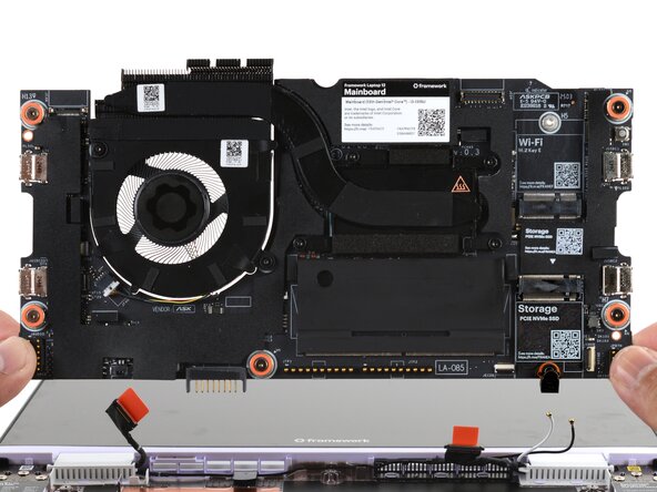

Once inside, the repair-friendly design really starts to shine. There are no ribbon cables between the keyboard and the mainboard. Instead, copper pads and pogo pins handle the job, reducing complexity and potential points of failure. The battery connector works the same way. No plugs or cables, just prongs that disengage when you lift it out.

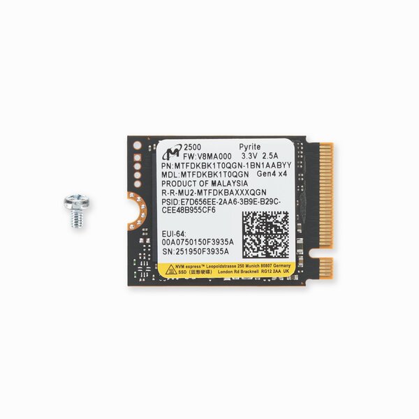

Storage and RAM are equally straightforward. The DDR5 sticks are standard SODIMM, and the short M.2 2230 SSD uses a clever, tool-free retention clip that secures the drive without any screws. This is the same drive form factor used in the Steam Deck, and replacements are easy to come by. It’s a smart choice for a device designed with longevity in mind.
And if you’re the kind of fixer who likes to keep things running clean, the fan module is easy to access and remove. Just one JST-style connector and a couple of captive screws. The heatsink comes away just as smoothly if you’re looking to reapply thermal paste down the road.

It’s not just that things are easy to remove. It’s the way the device helps you understand what you’re looking at. The mainboard is labeled with highlighted screw markers. All components from the speakers to the daughterboards come with QR codes linking directly to repair guides and numbering letting you know how many screws hold that component in place. Even the expansion cards (which already provided tool-free modularity in the Framework 13) have been updated with a secure locking mechanism similar to the design in the larger Framework 16.
