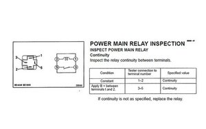

Why cant I put windows up and down
I'm unable to wind windows up or down cant find fuze

Harvey Adams if the power door look functions normal then you need to check:
1. GAUGE Fuse
2. Ignition Switch
3. P/W M–Fuse
4. Power Main Relay
5. Power Window Master Switch
