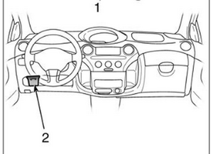

Hi,
Fuse #19. TAIL 10 A: Tail lights, parking lights, license plate lights, illuminations.
The taillight fuse is Fuse #19 in the instrument panel fuse box located under the instrument panel on the steering wheel side of the vehicle
Here are some images showing the location and layout of the fuse box
