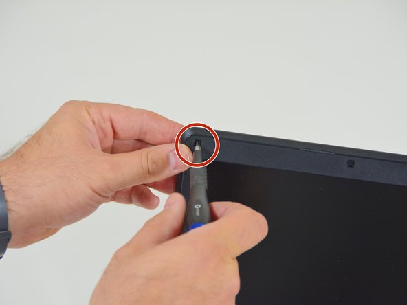

  2. why! W670SZQ1 Replacing the LCD screen, LCD screen: crwdns2935265:02crwdnd2935265:01crwdnd2935265:03crwdne2935265:0 why! W670SZQ1 Replacing the LCD screen, LCD screen: crwdns2935265:02crwdnd2935265:02crwdnd2935265:03crwdne2935265:0 why! W670SZQ1 Replacing the LCD screen, LCD screen: crwdns2935265:02crwdnd2935265:03crwdnd2935265:03crwdne2935265:0

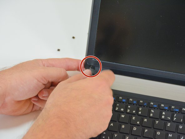

    • Start by locating the two screw caps on the left side of the screen.
    • Remove the lower screw cover.
    • Then the top screw cover.

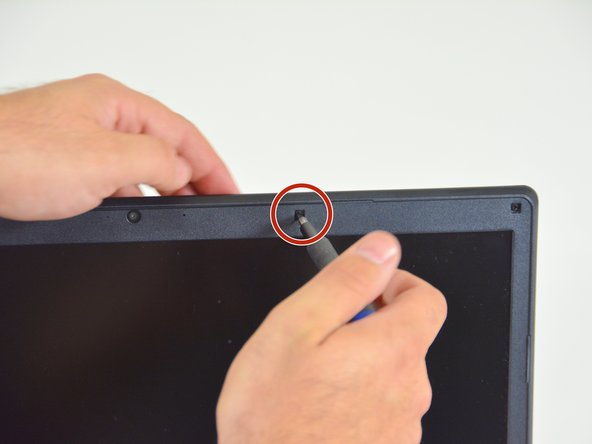

  3. why! W670SZQ1 Replacing the LCD screen: crwdns2935265:03crwdnd2935265:01crwdnd2935265:03crwdne2935265:0 why! W670SZQ1 Replacing the LCD screen: crwdns2935265:03crwdnd2935265:02crwdnd2935265:03crwdne2935265:0 why! W670SZQ1 Replacing the LCD screen: crwdns2935265:03crwdnd2935265:03crwdnd2935265:03crwdne2935265:0

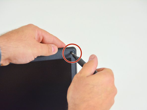

    • Locate and then remove the first center screw on the top of the screen frame.
    • Then the second central cap on the top of the screen frame.
    • Then locate and remove the screw cap on the upper right side of the screen frame.

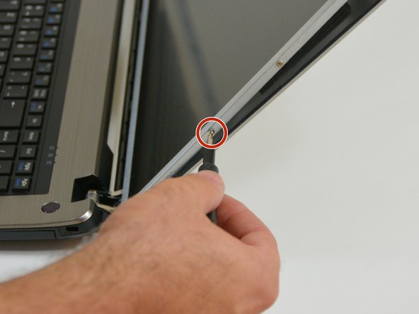

    • Then unscrew the screws behind the screw caps, starting with the one at the bottom left of the frame.
    • Then at the top left.
  5. why! W670SZQ1 Replacing the LCD screen: crwdns2935265:05crwdnd2935265:01crwdnd2935265:03crwdne2935265:0 why! W670SZQ1 Replacing the LCD screen: crwdns2935265:05crwdnd2935265:02crwdnd2935265:03crwdne2935265:0 why! W670SZQ1 Replacing the LCD screen: crwdns2935265:05crwdnd2935265:03crwdnd2935265:03crwdne2935265:0

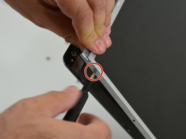

    • Then the first central screw on the top edge of the frame.
    • Then the second central screw on the top edge of the frame.
    • Then the one in the upper right corner of the frame.

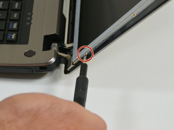

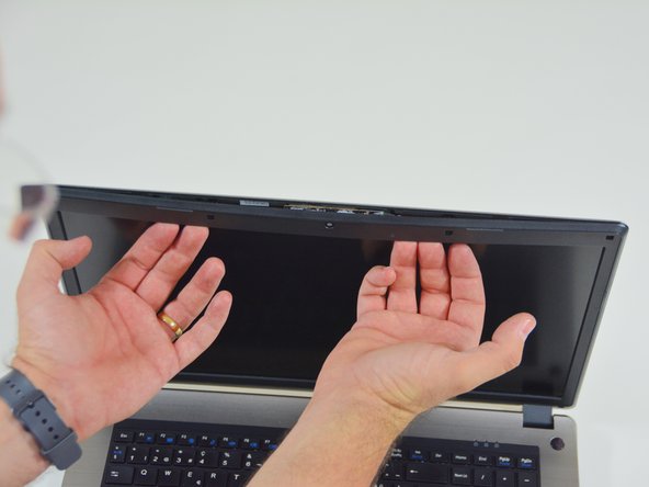

  6. why! W670SZQ1 Replacing the LCD screen: crwdns2935265:06crwdnd2935265:01crwdnd2935265:03crwdne2935265:0 why! W670SZQ1 Replacing the LCD screen: crwdns2935265:06crwdnd2935265:02crwdnd2935265:03crwdne2935265:0 why! W670SZQ1 Replacing the LCD screen: crwdns2935265:06crwdnd2935265:03crwdnd2935265:03crwdne2935265:0
    • And finally the one on the lower right side of the frame.

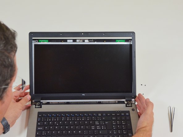

    • Then gently use your nails.
    • To remove the frame from the LCD screen.

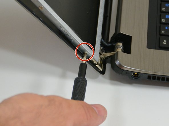

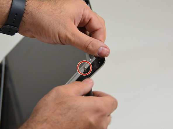

    • Unscrew the screws on the front of the LCD screen.
    • Next, unscrew the screws on the right side of the LCD screen, starting with the first one.
    • Then the second.

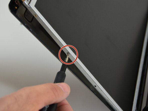

  8. why! W670SZQ1 Replacing the LCD screen: crwdns2935265:08crwdnd2935265:01crwdnd2935265:03crwdne2935265:0 why! W670SZQ1 Replacing the LCD screen: crwdns2935265:08crwdnd2935265:02crwdnd2935265:03crwdne2935265:0 why! W670SZQ1 Replacing the LCD screen: crwdns2935265:08crwdnd2935265:03crwdnd2935265:03crwdne2935265:0
    • Then the third.
    • And finally the fourth.
    • Repeat these operations then on the left side of the screen starting with the first screw.
  9. why! W670SZQ1 Replacing the LCD screen: crwdns2935265:09crwdnd2935265:01crwdnd2935265:03crwdne2935265:0 why! W670SZQ1 Replacing the LCD screen: crwdns2935265:09crwdnd2935265:02crwdnd2935265:03crwdne2935265:0 why! W670SZQ1 Replacing the LCD screen: crwdns2935265:09crwdnd2935265:03crwdnd2935265:03crwdne2935265:0
    • Then the second.
    • Then the third. .

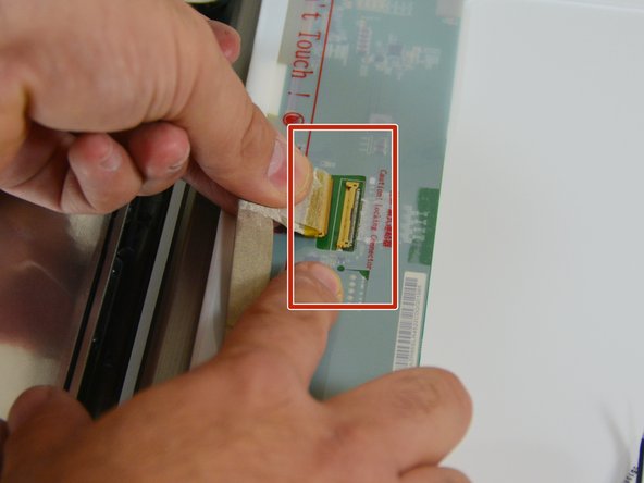

  10. why! W670SZQ1 Replacing the LCD screen: crwdns2935265:010crwdnd2935265:01crwdnd2935265:03crwdne2935265:0 why! W670SZQ1 Replacing the LCD screen: crwdns2935265:010crwdnd2935265:02crwdnd2935265:03crwdne2935265:0 why! W670SZQ1 Replacing the LCD screen: crwdns2935265:010crwdnd2935265:03crwdnd2935265:03crwdne2935265:0

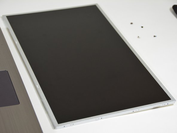

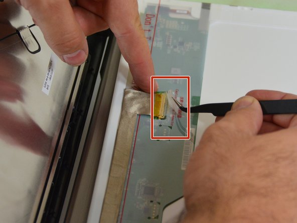

    • Then flip the LCD screen.

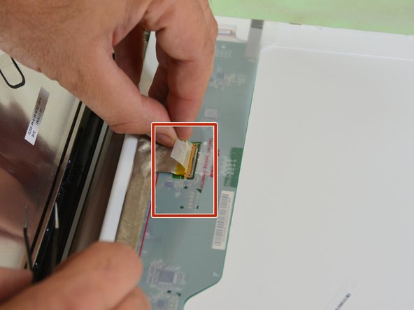

    • Then appears the connector to which is attached the connection cable of the LCD.
    • Then peel off the tape covering the connector.
  11. why! W670SZQ1 Replacing the LCD screen: crwdns2935265:011crwdnd2935265:01crwdnd2935265:03crwdne2935265:0 why! W670SZQ1 Replacing the LCD screen: crwdns2935265:011crwdnd2935265:02crwdnd2935265:03crwdne2935265:0 why! W670SZQ1 Replacing the LCD screen: crwdns2935265:011crwdnd2935265:03crwdnd2935265:03crwdne2935265:0
    • then remove the cable from its connector.
    • Once the cable is disconnected you can release the LCD screen.
to reassemble your device follow these instructions in reverse order.
