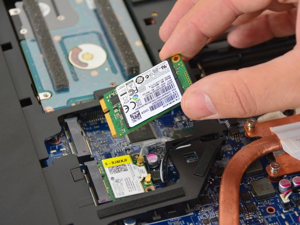

  3. why! W670SZQ1 Replacement SSD Disk, SSD disk: crwdns2935265:03crwdnd2935265:01crwdnd2935265:03crwdne2935265:0 why! W670SZQ1 Replacement SSD Disk, SSD disk: crwdns2935265:03crwdnd2935265:02crwdnd2935265:03crwdne2935265:0 why! W670SZQ1 Replacement SSD Disk, SSD disk: crwdns2935265:03crwdnd2935265:03crwdnd2935265:03crwdne2935265:0
    • Unscrew the SSD fixing screw using the Philips # 0 screwdriver.
    • Lift the SSD.
    • Remove the SSD from its connector.
To reassemble your device, follow the instructions in reverse order.
