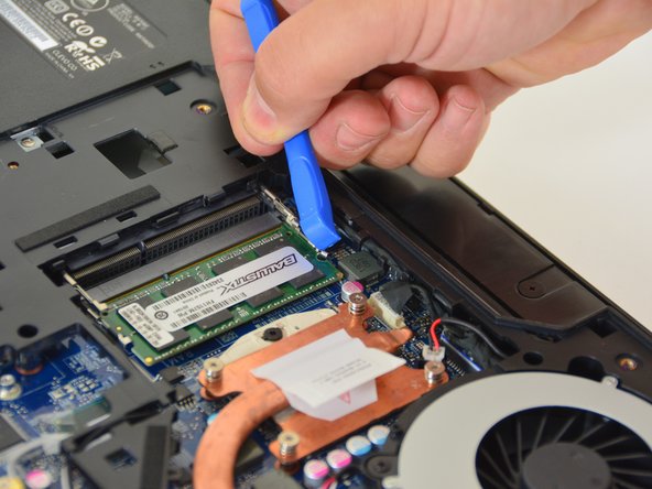

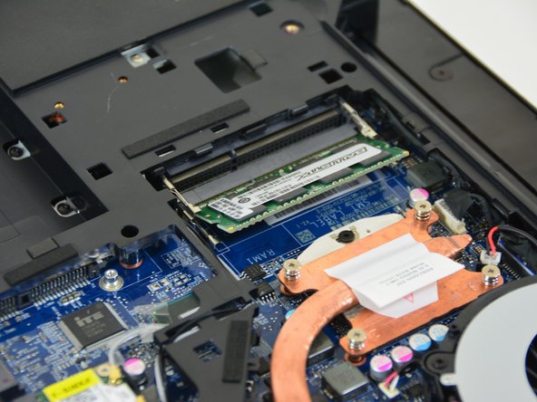

  3. why! W670SZQ1 Replacement RAM Memory Extension, RAM Memory: crwdns2935265:03crwdnd2935265:01crwdnd2935265:03crwdne2935265:0 why! W670SZQ1 Replacement RAM Memory Extension, RAM Memory: crwdns2935265:03crwdnd2935265:02crwdnd2935265:03crwdne2935265:0 why! W670SZQ1 Replacement RAM Memory Extension, RAM Memory: crwdns2935265:03crwdnd2935265:03crwdnd2935265:03crwdne2935265:0
    • Locate the RAM card in its slot.
    • Spread the leaf springs that hold the memory module in place (left and right).
    • Remove the memory module (RAM) from its connector.
To reassemble your device, Follow these instructions in reverse order.
