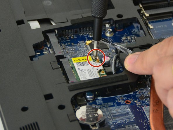

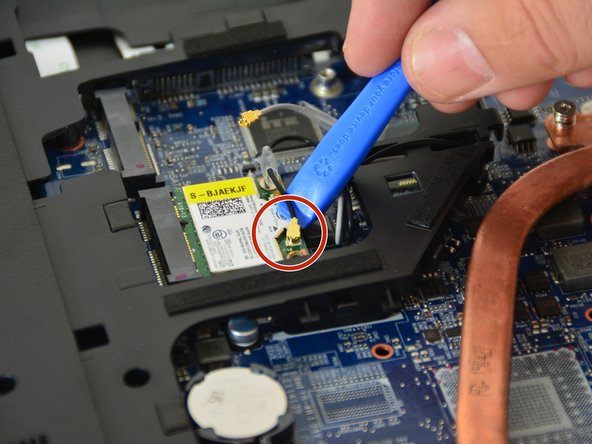

  3. why! W670SZQ1 Remplacement Carte WLAN / Bluetooth, Carte WLAN / Bluetooth: crwdns2935265:03crwdnd2935265:01crwdnd2935265:03crwdne2935265:0 why! W670SZQ1 Remplacement Carte WLAN / Bluetooth, Carte WLAN / Bluetooth: crwdns2935265:03crwdnd2935265:02crwdnd2935265:03crwdne2935265:0 why! W670SZQ1 Remplacement Carte WLAN / Bluetooth, Carte WLAN / Bluetooth: crwdns2935265:03crwdnd2935265:03crwdnd2935265:03crwdne2935265:0
    • First disconnect one of the antenna connectors.
    • Then the other connector.
    • Unscrew the fixing screw with the Philips # 0 screwdriver. Then slightly lift the chipset and remove it from the mSATA connector.
TO REASSEMBLE YOUR DEVICE FOLLOW THE FOLLOWING INSTRUCTIONS IN REVERSE ORDER.
