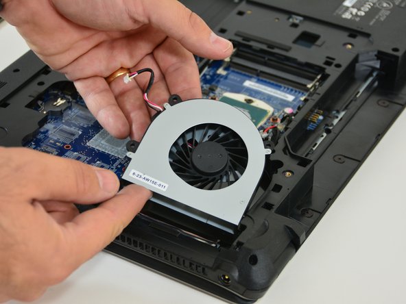

  3. why! W670SZQ1 Fan Replacement, The fan: crwdns2935265:03crwdnd2935265:01crwdnd2935265:03crwdne2935265:0 why! W670SZQ1 Fan Replacement, The fan: crwdns2935265:03crwdnd2935265:02crwdnd2935265:03crwdne2935265:0 why! W670SZQ1 Fan Replacement, The fan: crwdns2935265:03crwdnd2935265:03crwdnd2935265:03crwdne2935265:0
    • Start by disconnecting the power cable from the fan.
    • Then unscrew the three screws holding the fan in place.
    • Finally, disengage the fan from its location by lifting it up.
To reassemble your device follow these instructions in reverse order.
