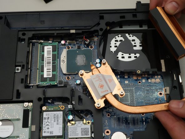

    • Using a Phillips screwdriver, unscrew the four captive screws securing the heatsink to the motherboard.
    • Remove the heatsink.

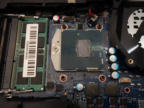

    • The processor and its retention mechanism is now visible.

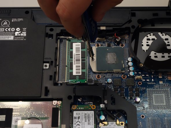

    • Unlock the processor using a small Torx screwdriver by turning the lock 180 degrees counterclockwise

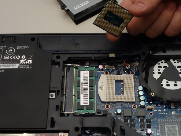

    • Make sure the locking latch is pointing in the opposite direction.
    • You can now carefully remove the processor from its socket.
