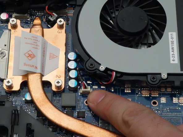

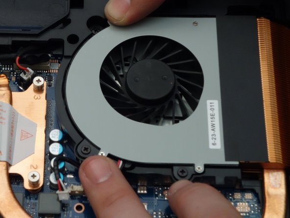

  3. why! W650SZ CPU Fan Replacement, CPU Fan: crwdns2935265:03crwdnd2935265:01crwdnd2935265:03crwdne2935265:0 why! W650SZ CPU Fan Replacement, CPU Fan: crwdns2935265:03crwdnd2935265:02crwdnd2935265:03crwdne2935265:0 why! W650SZ CPU Fan Replacement, CPU Fan: crwdns2935265:03crwdnd2935265:03crwdnd2935265:03crwdne2935265:0
    • Start by locating the fan.
    • Unplug the power cable from the motherboard.
    • Remove the three screws that secure the fan.

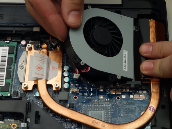

  4. why! W650SZ CPU Fan Replacement: crwdns2935265:04crwdnd2935265:01crwdnd2935265:02crwdne2935265:0 why! W650SZ CPU Fan Replacement: crwdns2935265:04crwdnd2935265:02crwdnd2935265:02crwdne2935265:0
    • Pry the fan up slightly with a flat blade screwdriver.
    • Lift the fan up to remove it.
