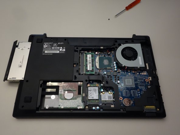

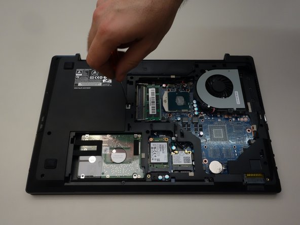

  3. why! W650SZ CD/DVD Drive Replacement, CD/DVD Drive: crwdns2935265:03crwdnd2935265:01crwdnd2935265:03crwdne2935265:0 why! W650SZ CD/DVD Drive Replacement, CD/DVD Drive: crwdns2935265:03crwdnd2935265:02crwdnd2935265:03crwdne2935265:0 why! W650SZ CD/DVD Drive Replacement, CD/DVD Drive: crwdns2935265:03crwdnd2935265:03crwdnd2935265:03crwdne2935265:0
    • Locate the screw securing the CD/DVD drive.
    • Remove the Phillips screw securing the drive.
    • Remove the CD/DVD drive by simply sliding it out from the chassis.
