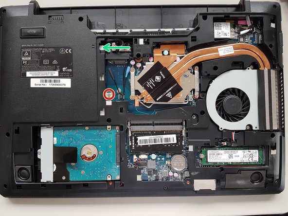

  3. why! N650DU CD / DVD RW drive, CD / DVD RW drive: crwdns2935265:03crwdnd2935265:01crwdnd2935265:03crwdne2935265:0 why! N650DU CD / DVD RW drive, CD / DVD RW drive: crwdns2935265:03crwdnd2935265:02crwdnd2935265:03crwdne2935265:0 why! N650DU CD / DVD RW drive, CD / DVD RW drive: crwdns2935265:03crwdnd2935265:03crwdnd2935265:03crwdne2935265:0
    • Unscrew the screw circled in red
    • Push the drive to the location indicated by the green arrow
    • Remove the drive from its location
To reassemble your device, Follow these instructions in reverse order.
