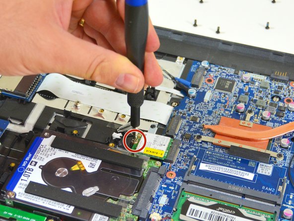

  7. why! N240JU Replacement motherboard, WLAN card: crwdns2935265:07crwdnd2935265:01crwdnd2935265:02crwdne2935265:0 why! N240JU Replacement motherboard, WLAN card: crwdns2935265:07crwdnd2935265:02crwdnd2935265:02crwdne2935265:0
    • Carefully unplug the MAIN and AUX antennas.
    • Unscrew the fixing screw with the Philips # 0 screwdriver. Then lift the chipset slightly and remove it from the connector.

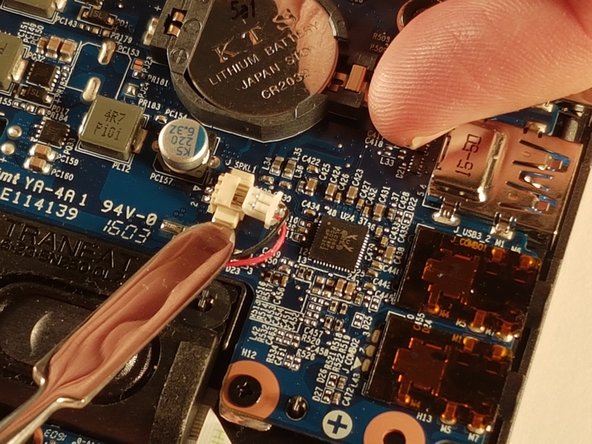

    • Locate the five connectors on the motherboard
    • Unplug all connectors
  14. why! N240JU Replacement motherboard: crwdns2935265:014crwdnd2935265:01crwdnd2935265:03crwdne2935265:0 why! N240JU Replacement motherboard: crwdns2935265:014crwdnd2935265:02crwdnd2935265:03crwdne2935265:0 why! N240JU Replacement motherboard: crwdns2935265:014crwdnd2935265:03crwdnd2935265:03crwdne2935265:0

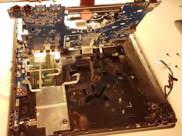

  15. why! N240JU Replacement motherboard: crwdns2935265:015crwdnd2935265:01crwdnd2935265:02crwdne2935265:0 why! N240JU Replacement motherboard: crwdns2935265:015crwdnd2935265:02crwdnd2935265:02crwdne2935265:0
    • Unscrew the four screws circled in red
    • Lift the motherboard by taking it through the radiator

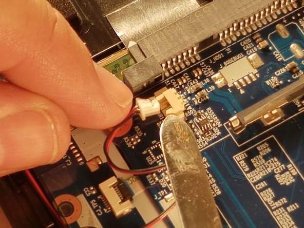

  16. why! N240JU Replacement motherboard: crwdns2935265:016crwdnd2935265:01crwdnd2935265:03crwdne2935265:0 why! N240JU Replacement motherboard: crwdns2935265:016crwdnd2935265:02crwdnd2935265:03crwdne2935265:0 why! N240JU Replacement motherboard: crwdns2935265:016crwdnd2935265:03crwdnd2935265:03crwdne2935265:0
    • Disconnect the two connectors circled in red
