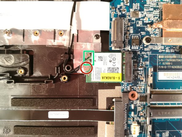

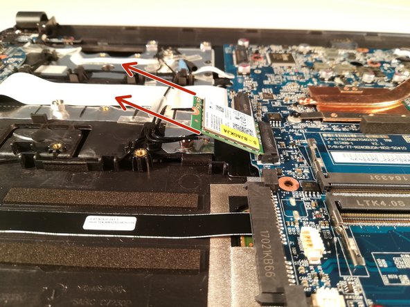

  4. why! N240BU WLAN Card replacement, WLAN Card: crwdns2935265:04crwdnd2935265:01crwdnd2935265:03crwdne2935265:0 why! N240BU WLAN Card replacement, WLAN Card: crwdns2935265:04crwdnd2935265:02crwdnd2935265:03crwdne2935265:0 why! N240BU WLAN Card replacement, WLAN Card: crwdns2935265:04crwdnd2935265:03crwdnd2935265:03crwdne2935265:0
    • Remove the screw circled in red
    • Disconnect the two connectors marked in green
    • Remove the WLAN card
To reassemble your device, follow these instructions in reverse order
