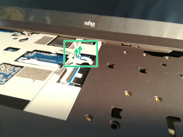

  2. why! N240BU Motherboard Replacement, The keyboard: crwdns2935265:02crwdnd2935265:01crwdnd2935265:03crwdne2935265:0 why! N240BU Motherboard Replacement, The keyboard: crwdns2935265:02crwdnd2935265:02crwdnd2935265:03crwdne2935265:0 why! N240BU Motherboard Replacement, The keyboard: crwdns2935265:02crwdnd2935265:03crwdnd2935265:03crwdne2935265:0
    • Unscrew the circled screws in green and red
    • Put the computer in the position of the second image while pushing a paper clip into the hole of the screw circled in green until you hear a click
    • Lift the keyboard

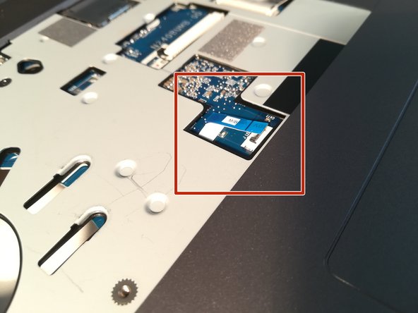

  4. why! N240BU Motherboard Replacement, Access to main components: crwdns2935265:04crwdnd2935265:01crwdnd2935265:02crwdne2935265:0 why! N240BU Motherboard Replacement, Access to main components: crwdns2935265:04crwdnd2935265:02crwdnd2935265:02crwdne2935265:0
    • Begin by spotting the dummy memory card.
    • Then, remove it and put it on your workplan.

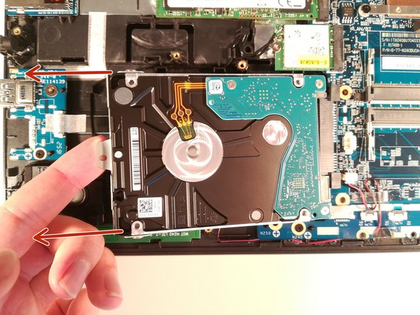

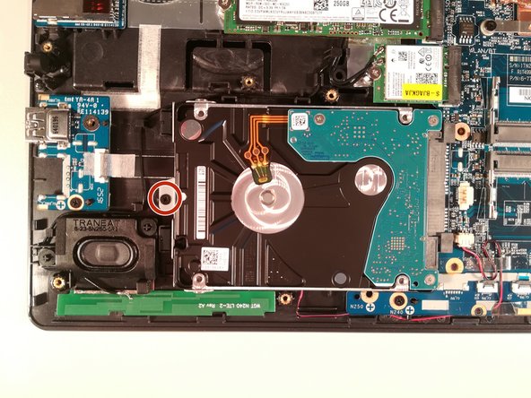

  7. why! N240BU Motherboard Replacement, Hard Drive (mass storage): crwdns2935265:07crwdnd2935265:01crwdnd2935265:03crwdne2935265:0 why! N240BU Motherboard Replacement, Hard Drive (mass storage): crwdns2935265:07crwdnd2935265:02crwdnd2935265:03crwdne2935265:0 why! N240BU Motherboard Replacement, Hard Drive (mass storage): crwdns2935265:07crwdnd2935265:03crwdnd2935265:03crwdne2935265:0
    • Remove the screw circled in red
    • Lift up the hard drive
    • Remove the hard drive in the direction of the red arrows

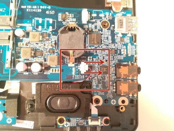

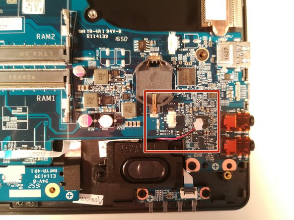

  10. why! N240BU Motherboard Replacement, CMOS Battery: crwdns2935265:010crwdnd2935265:01crwdnd2935265:02crwdne2935265:0 why! N240BU Motherboard Replacement, CMOS Battery: crwdns2935265:010crwdnd2935265:02crwdnd2935265:02crwdne2935265:0
    • Press with a screwdriver in the red circled area to spread the base of the battery
    • Remove the battery by holding the screwdriver down

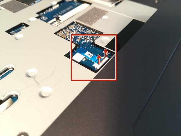

  12. why! N240BU Motherboard Replacement, Motherboard: crwdns2935265:012crwdnd2935265:01crwdnd2935265:03crwdne2935265:0 why! N240BU Motherboard Replacement, Motherboard: crwdns2935265:012crwdnd2935265:02crwdnd2935265:03crwdne2935265:0 why! N240BU Motherboard Replacement, Motherboard: crwdns2935265:012crwdnd2935265:03crwdnd2935265:03crwdne2935265:0

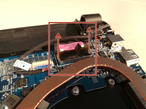

    • Lift the retaining flap off of the connector boxed in red.
    • Disconnect the connector boxed in red.

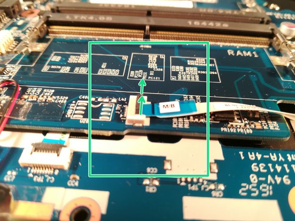

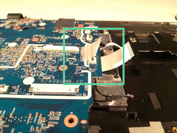

  13. why! N240BU Motherboard Replacement: crwdns2935265:013crwdnd2935265:01crwdnd2935265:03crwdne2935265:0 why! N240BU Motherboard Replacement: crwdns2935265:013crwdnd2935265:02crwdnd2935265:03crwdne2935265:0 why! N240BU Motherboard Replacement: crwdns2935265:013crwdnd2935265:03crwdnd2935265:03crwdne2935265:0

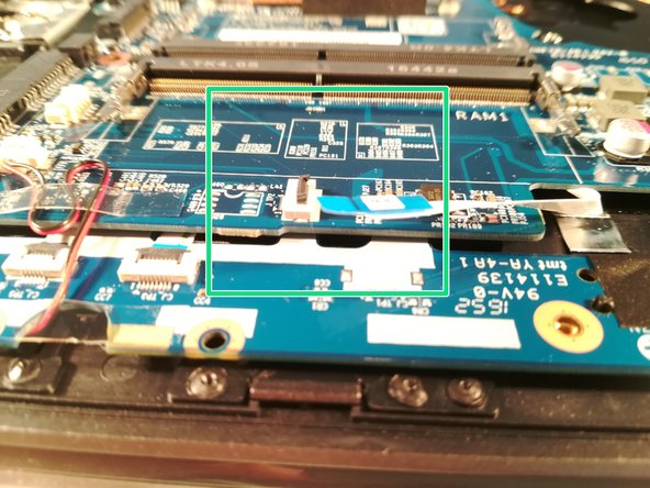

    • Lift the flap that holds the connector (framed in green)
    • Disconnect the connector (framed in green)

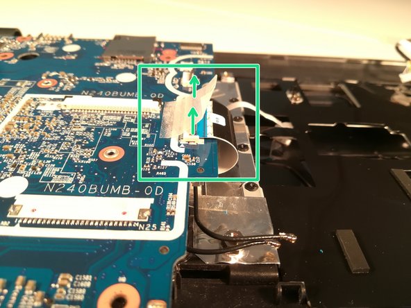

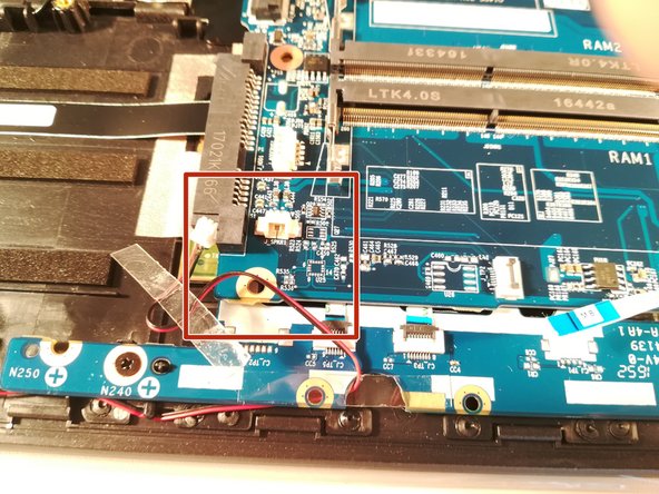

    • Disconnect the connector marked in red by lifting it up
  15. why! N240BU Motherboard Replacement: crwdns2935265:015crwdnd2935265:01crwdnd2935265:03crwdne2935265:0 why! N240BU Motherboard Replacement: crwdns2935265:015crwdnd2935265:02crwdnd2935265:03crwdne2935265:0 why! N240BU Motherboard Replacement: crwdns2935265:015crwdnd2935265:03crwdnd2935265:03crwdne2935265:0
    • Disconnect the connector marked in green by pulling it in the direction of green arrows

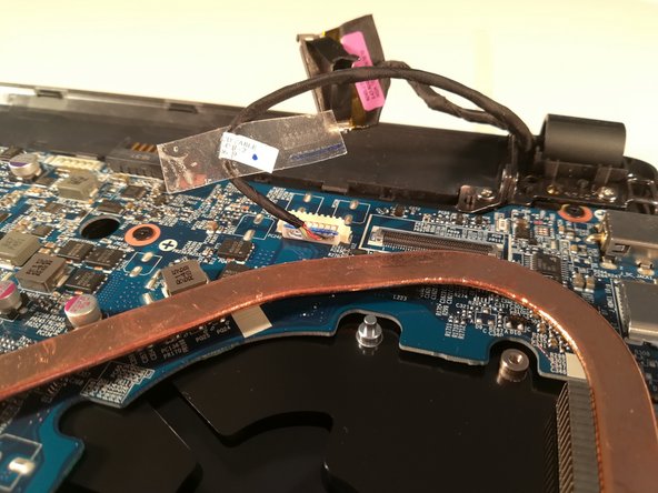

  16. why! N240BU Motherboard Replacement: crwdns2935265:016crwdnd2935265:01crwdnd2935265:03crwdne2935265:0 why! N240BU Motherboard Replacement: crwdns2935265:016crwdnd2935265:02crwdnd2935265:03crwdne2935265:0 why! N240BU Motherboard Replacement: crwdns2935265:016crwdnd2935265:03crwdnd2935265:03crwdne2935265:0
    • Disconnect the connector marked in red by pulling it in the direction of the red arrows

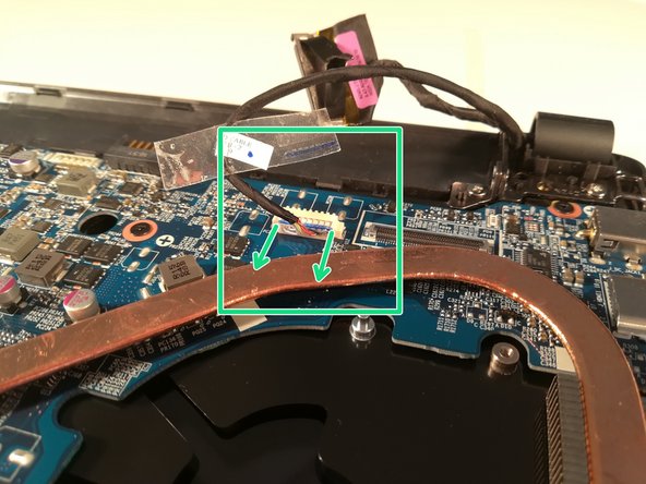

  18. why! N240BU Motherboard Replacement: crwdns2935265:018crwdnd2935265:01crwdnd2935265:03crwdne2935265:0 why! N240BU Motherboard Replacement: crwdns2935265:018crwdnd2935265:02crwdnd2935265:03crwdne2935265:0 why! N240BU Motherboard Replacement: crwdns2935265:018crwdnd2935265:03crwdnd2935265:03crwdne2935265:0

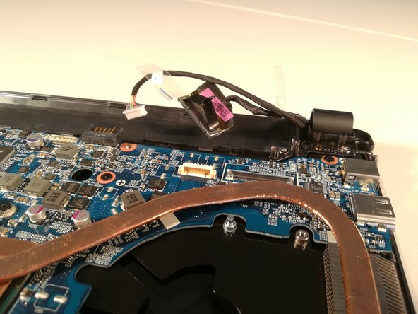

  19. why! N240BU Motherboard Replacement: crwdns2935265:019crwdnd2935265:01crwdnd2935265:03crwdne2935265:0 why! N240BU Motherboard Replacement: crwdns2935265:019crwdnd2935265:02crwdnd2935265:03crwdne2935265:0 why! N240BU Motherboard Replacement: crwdns2935265:019crwdnd2935265:03crwdnd2935265:03crwdne2935265:0

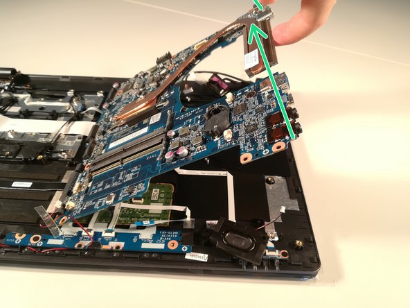

    • Unscrew the five screws circled in green
    • Lift the motherboard by taking it by the radiator as in the second picture

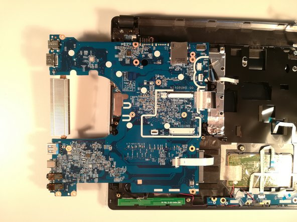

    • Lift the retaining flap that holds the connector marked in red
  21. why! N240BU Motherboard Replacement: crwdns2935265:021crwdnd2935265:01crwdnd2935265:03crwdne2935265:0 why! N240BU Motherboard Replacement: crwdns2935265:021crwdnd2935265:02crwdnd2935265:03crwdne2935265:0 why! N240BU Motherboard Replacement: crwdns2935265:021crwdnd2935265:03crwdnd2935265:03crwdne2935265:0
    • Lift the retaining flap that holds the connector framed in green
    • Disconnect the connector boxed in green
    • Remove the motherboard from the case.
