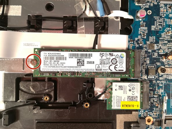

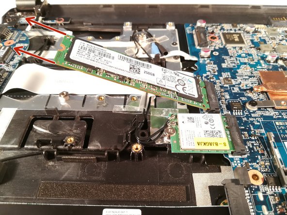

  4. why! N240BU Hard Drive M.2 Replacement, SSD Hard Drive: crwdns2935265:04crwdnd2935265:01crwdnd2935265:03crwdne2935265:0 why! N240BU Hard Drive M.2 Replacement, SSD Hard Drive: crwdns2935265:04crwdnd2935265:02crwdnd2935265:03crwdne2935265:0 why! N240BU Hard Drive M.2 Replacement, SSD Hard Drive: crwdns2935265:04crwdnd2935265:03crwdnd2935265:03crwdne2935265:0
    • Unscrew the screw circled in red
    • Pull out the M.2 SSD in the direction of the red arrows
