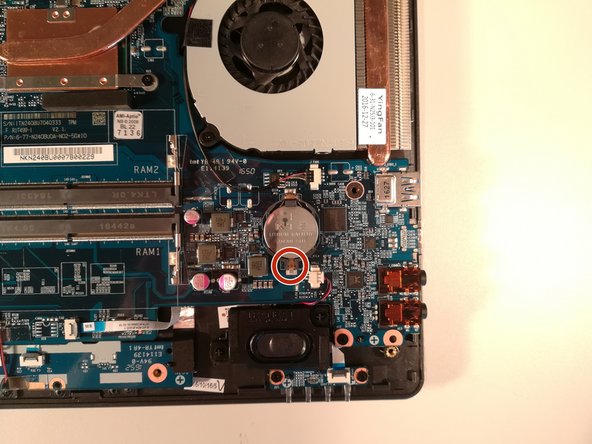

  4. why! N240BU CMOS Battery Replacement, CMOS Battery: crwdns2935265:04crwdnd2935265:01crwdnd2935265:02crwdne2935265:0 why! N240BU CMOS Battery Replacement, CMOS Battery: crwdns2935265:04crwdnd2935265:02crwdnd2935265:02crwdne2935265:0
    • Press with a screwdriver in the red circled area to spread the base of the battery
    • Remove the battery by holding the screwdriver down
To reassemble your device follow the following instructions in reverse order
