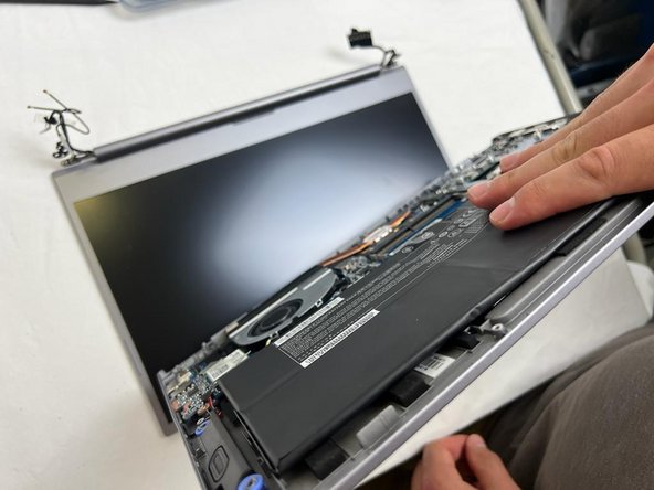

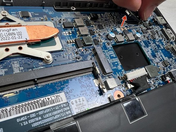

  2. why! L140/1PU right hinge replacement, Disconnection: crwdns2935265:02crwdnd2935265:01crwdnd2935265:02crwdne2935265:0 why! L140/1PU right hinge replacement, Disconnection: crwdns2935265:02crwdnd2935265:02crwdnd2935265:02crwdne2935265:0

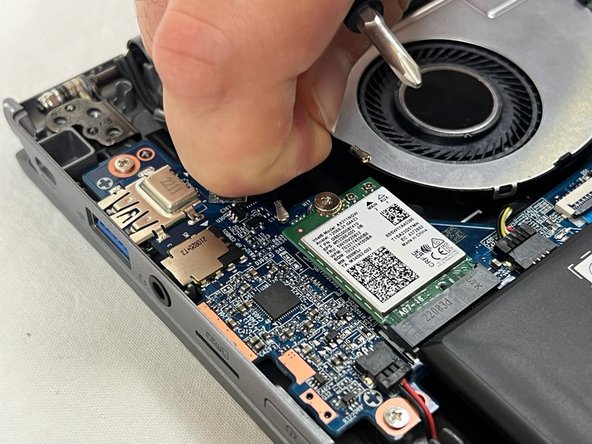

    • For safety reasons, the battery must be disconnected before each intervention.
    • Disconnect the battery your fingers.
    • Other components can now be replaced safely.

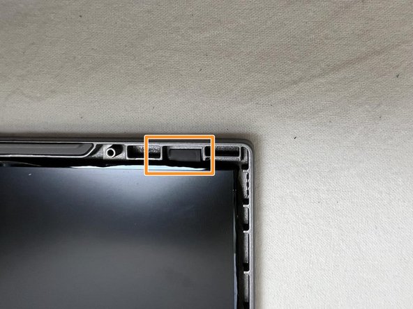

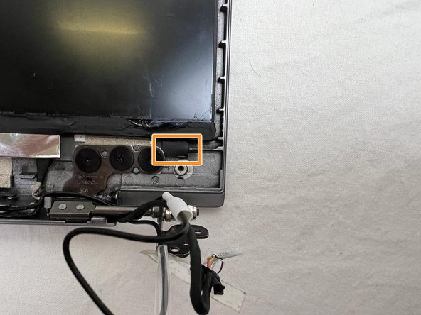

  3. why! L140/1PU right hinge replacement, Upper frame 1: crwdns2935265:03crwdnd2935265:01crwdnd2935265:03crwdne2935265:0 why! L140/1PU right hinge replacement, Upper frame 1: crwdns2935265:03crwdnd2935265:02crwdnd2935265:03crwdne2935265:0 why! L140/1PU right hinge replacement, Upper frame 1: crwdns2935265:03crwdnd2935265:03crwdnd2935265:03crwdne2935265:0
    • The orange squares indicate the zones we will focus on.
    • Unplug the screen cable.

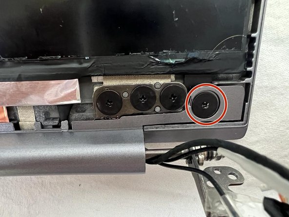

    • Unscrew the screw of the cover and those of the hinge. Remove the cover.

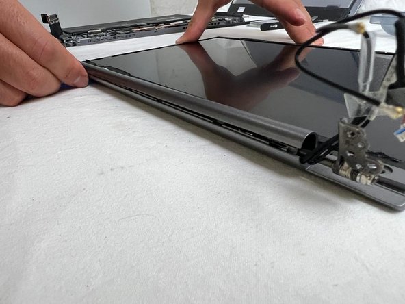

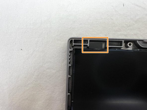

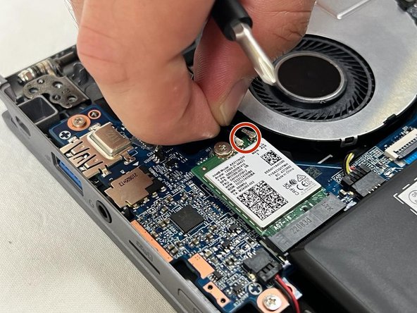

  4. why! L140/1PU right hinge replacement, Upper frame 2: crwdns2935265:04crwdnd2935265:01crwdnd2935265:03crwdne2935265:0 why! L140/1PU right hinge replacement, Upper frame 2: crwdns2935265:04crwdnd2935265:02crwdnd2935265:03crwdne2935265:0 why! L140/1PU right hinge replacement, Upper frame 2: crwdns2935265:04crwdnd2935265:03crwdnd2935265:03crwdne2935265:0
    • Unscrew the screw of the cover, and those of the hinge. Remove the cover.
    • Unplug the Wifi cables.

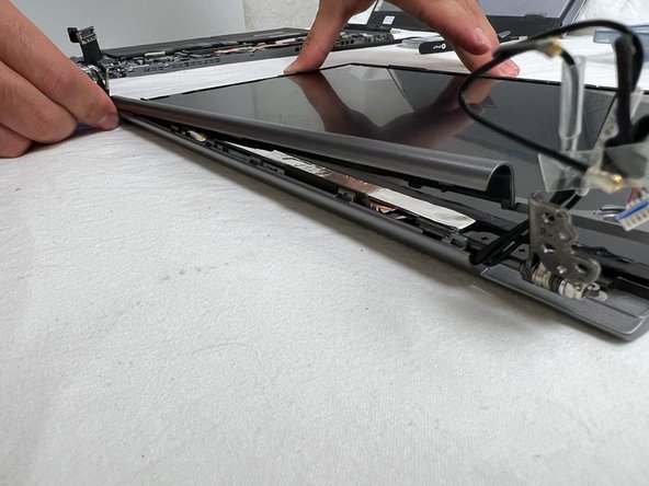

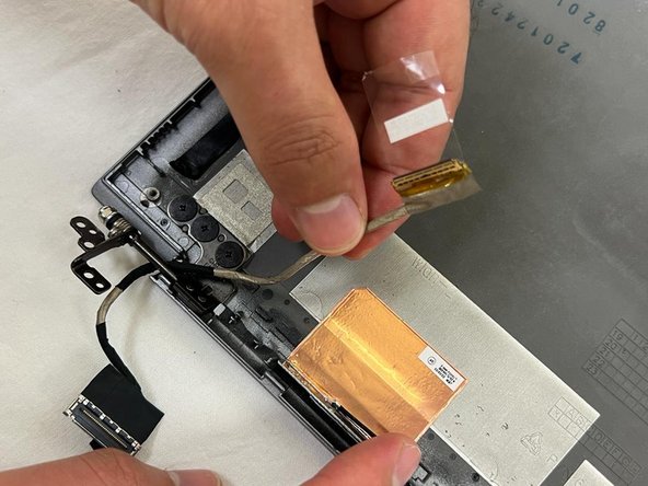

  5. why! L140/1PU right hinge replacement, Upper frame 3: crwdns2935265:05crwdnd2935265:01crwdnd2935265:03crwdne2935265:0 why! L140/1PU right hinge replacement, Upper frame 3: crwdns2935265:05crwdnd2935265:02crwdnd2935265:03crwdne2935265:0 why! L140/1PU right hinge replacement, Upper frame 3: crwdns2935265:05crwdnd2935265:03crwdnd2935265:03crwdne2935265:0
    • Unplug the camera cable.
    • Open the two hinges.

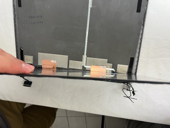

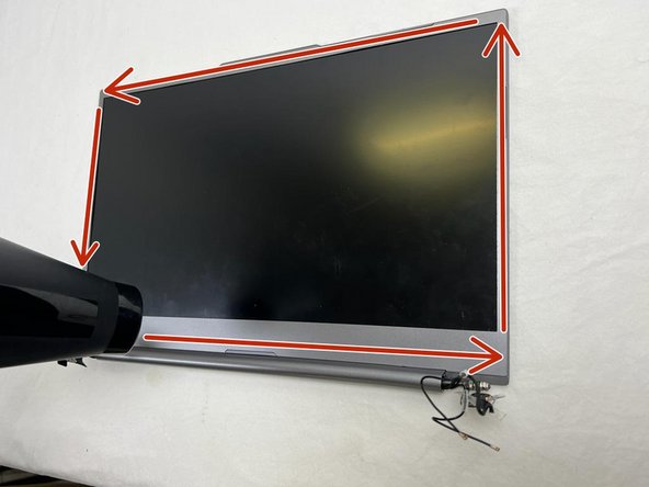

  6. why! L140/1PU right hinge replacement, Upper frame 4: crwdns2935265:06crwdnd2935265:01crwdnd2935265:03crwdne2935265:0 why! L140/1PU right hinge replacement, Upper frame 4: crwdns2935265:06crwdnd2935265:02crwdnd2935265:03crwdne2935265:0 why! L140/1PU right hinge replacement, Upper frame 4: crwdns2935265:06crwdnd2935265:03crwdnd2935265:03crwdne2935265:0
    • Remove the upper case, separating it from the screen.
    • Using a hair dryer, blow hot air around the screen to soften the frame's adhesive.
    • In order to avoid damaging components, never keep the hair dryer aimed at the same spot.

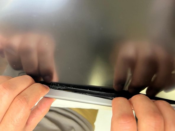

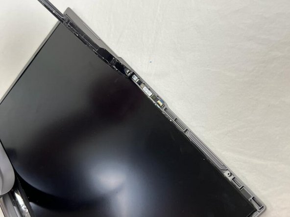

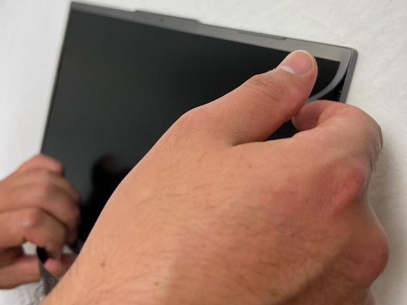

  7. why! L140/1PU right hinge replacement, Upper Frame 5: crwdns2935265:07crwdnd2935265:01crwdnd2935265:03crwdne2935265:0 why! L140/1PU right hinge replacement, Upper Frame 5: crwdns2935265:07crwdnd2935265:02crwdnd2935265:03crwdne2935265:0 why! L140/1PU right hinge replacement, Upper Frame 5: crwdns2935265:07crwdnd2935265:03crwdnd2935265:03crwdne2935265:0
    • Separate the frame.
    • You can use the iFixit opening pick for this, or just your fingernails.
  8. why! L140/1PU right hinge replacement: crwdns2935265:08crwdnd2935265:01crwdnd2935265:02crwdne2935265:0 why! L140/1PU right hinge replacement: crwdns2935265:08crwdnd2935265:02crwdnd2935265:02crwdne2935265:0

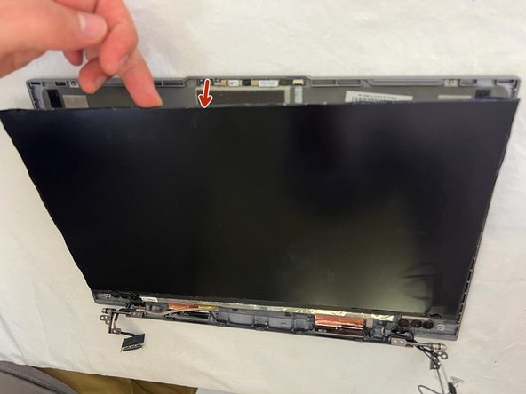

    • Remove the upper frame of the screen.
  9. why! L140/1PU right hinge replacement, Lower screen 1: crwdns2935265:09crwdnd2935265:01crwdnd2935265:02crwdne2935265:0 why! L140/1PU right hinge replacement, Lower screen 1: crwdns2935265:09crwdnd2935265:02crwdnd2935265:02crwdne2935265:0

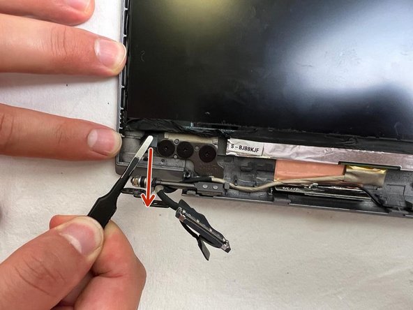

    • Remove the four strips of tape.
  12. why! L140/1PU right hinge replacement, Screen 2: crwdns2935265:012crwdnd2935265:01crwdnd2935265:03crwdne2935265:0 why! L140/1PU right hinge replacement, Screen 2: crwdns2935265:012crwdnd2935265:02crwdnd2935265:03crwdne2935265:0 why! L140/1PU right hinge replacement, Screen 2: crwdns2935265:012crwdnd2935265:03crwdnd2935265:03crwdne2935265:0
    • Using tweezers, grasp and gently pull the tape.
  13. why! L140/1PU right hinge replacement, Screen 3: crwdns2935265:013crwdnd2935265:01crwdnd2935265:03crwdne2935265:0 why! L140/1PU right hinge replacement, Screen 3: crwdns2935265:013crwdnd2935265:02crwdnd2935265:03crwdne2935265:0 why! L140/1PU right hinge replacement, Screen 3: crwdns2935265:013crwdnd2935265:03crwdnd2935265:03crwdne2935265:0
    • Pull the tape until it is freed. Repeat on all 3 other sides.

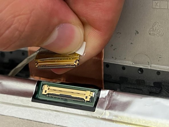

  14. why! L140/1PU right hinge replacement, Screen 4: crwdns2935265:014crwdnd2935265:01crwdnd2935265:03crwdne2935265:0 why! L140/1PU right hinge replacement, Screen 4: crwdns2935265:014crwdnd2935265:02crwdnd2935265:03crwdne2935265:0 why! L140/1PU right hinge replacement, Screen 4: crwdns2935265:014crwdnd2935265:03crwdnd2935265:03crwdne2935265:0
    • Remove the tape.
    • Remove the screen cable.

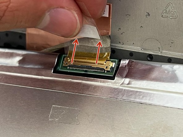

  15. why! L140/1PU right hinge replacement, EDP: crwdns2935265:015crwdnd2935265:01crwdnd2935265:02crwdne2935265:0 why! L140/1PU right hinge replacement, EDP: crwdns2935265:015crwdnd2935265:02crwdnd2935265:02crwdne2935265:0
    • Release the cable and remove it.

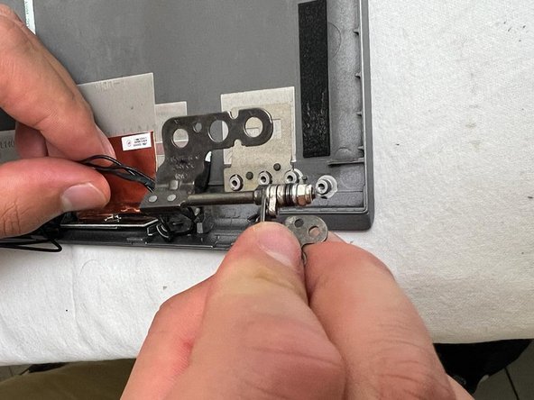

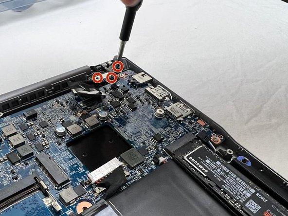

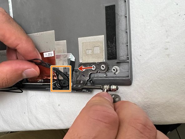

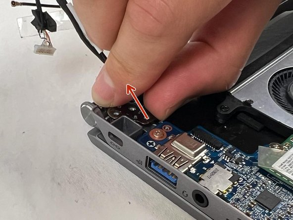

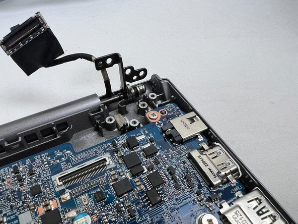

  16. why! L140/1PU right hinge replacement, Right hinge: crwdns2935265:016crwdnd2935265:01crwdnd2935265:03crwdne2935265:0 why! L140/1PU right hinge replacement, Right hinge: crwdns2935265:016crwdnd2935265:02crwdnd2935265:03crwdne2935265:0 why! L140/1PU right hinge replacement, Right hinge: crwdns2935265:016crwdnd2935265:03crwdnd2935265:03crwdne2935265:0
    • Unscrew all three screws.
    • Move the cables.
    • Remove the hinge.
