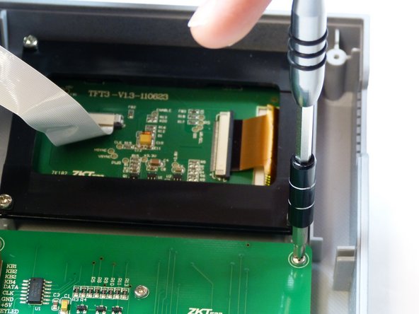

The keyboard is a vital component to the function of the unit. This guide will show to remove and replace the keyboard. Take care not to damage the keyboard when removed.
    1. uAttend bn6000 Keyboard Replacement, Disassembly: crwdns2935265:01crwdnd2935265:01crwdnd2935265:01crwdne2935265:0
      • Make sure to unplug the device before starting.
      • Flip the device over.
      • Remove the four 10mm PH #2 screws by rotating the screwdriver counterclockwise, removing the screw from the housing completely.
    2. uAttend bn6000 Keyboard Replacement: crwdns2935265:02crwdnd2935265:01crwdnd2935265:01crwdne2935265:0
      • Separate the two cover pieces carefully by pulling apart the two cover pieces away from each other.
    1. uAttend bn6000 Keyboard Replacement, Keyboard: crwdns2935265:03crwdnd2935265:01crwdnd2935265:02crwdne2935265:0 uAttend bn6000 Keyboard Replacement, Keyboard: crwdns2935265:03crwdnd2935265:02crwdnd2935265:02crwdne2935265:0
      • Remove the five 7mm PH #1 screws from the back of the keypad, by rotating the screw driver counter clockwise, removing the screw from the housing completely.
    2. uAttend bn6000 Keyboard Replacement: crwdns2935265:04crwdnd2935265:01crwdnd2935265:01crwdne2935265:0
      • Remove the bundled cable connector from the keyboard by pulling the cable away from the connector in the same direction as the individual wires are running.
