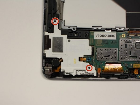

  • Remove the two 3mm screws securing the white speaker with the Phillips #00 screwdriver.
