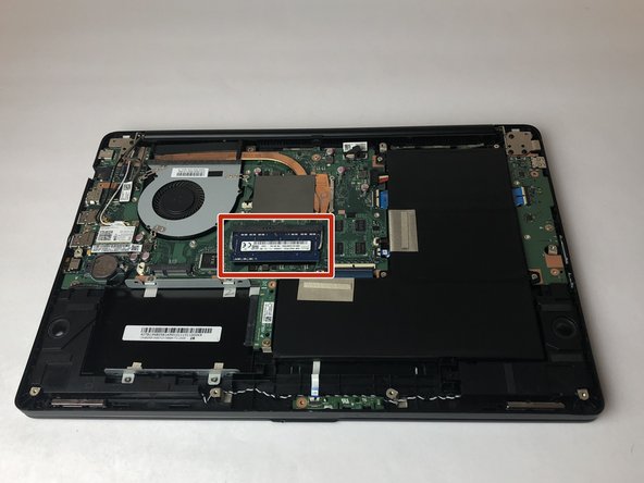

  • The RAM is the rectangular plate in the center.
  • Use a spudger to press the clips securing the RAM outward. The RAM will pop up enabling you to lift it out.
