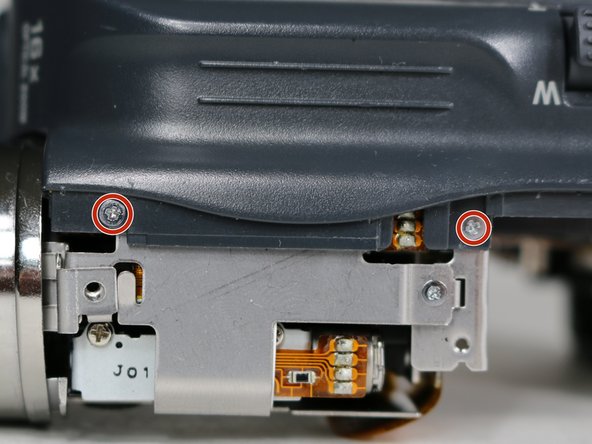

  • From the top of the camera remove the two 3.1 mm screws securing the lens to the camera frame.
  • From the bottom of the camera remove the 3.2 mm screw next to the battery release switch.
  • Remove the 9.1 mm screw next to the menu and volume control label.
