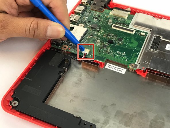

  • Using the plastic opening tool, disconnect the audio connector by pushing the audio tab toward the speakers.
  • With the audio cable detached, carefully lift the speakers out of the device.
