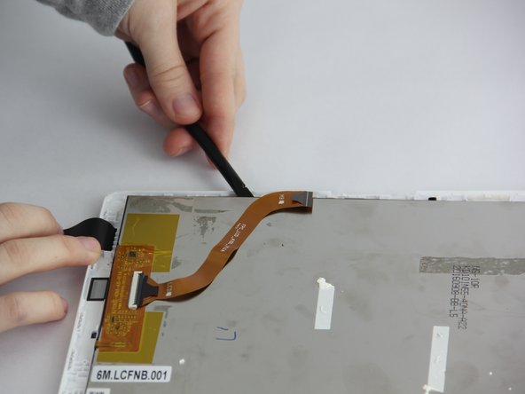

  • Using the plastic spudger gently pry the screen along the plastic clips.
  • Once at least 1/2 of the screen is unclipped slide it out of the frame using hands.
