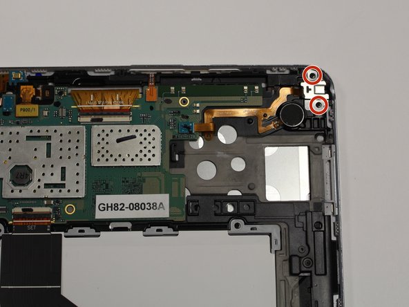

  • Remove the two 3mm Phillips #00 screws over the silver cover.
  • The silver cover is attached to the whole audio jack; do not try to pull this away by itself.
