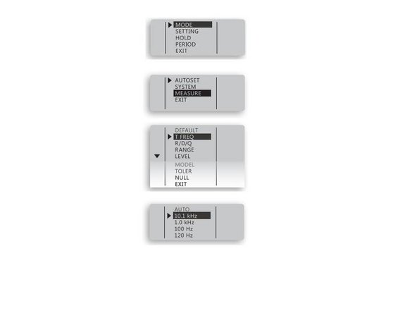

  • Now the Test Frequency needs to be changed to 10KHz.
  • Press the Navigation button again, and select MEASURE. Then SETTING, then T.FREQ. Select 10KHz.
  • The number on the screen that appears is the capacitance between the two tweezer tips at their default distance. This is the Capacitance Offset.
  • The offset is varied by the distance between the tips. The smaller the component, the closer the tips are together, thus a higher offset evaluation.
