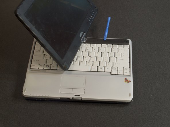

Fujitsu LifeBook T730 Display Replacement, Remove the forward keyboard/screen bezel: crwdns2935265:00crwdnd2935265:01crwdnd2935265:02crwdne2935265:0 Fujitsu LifeBook T730 Display Replacement, Remove the forward keyboard/screen bezel: crwdns2935265:00crwdnd2935265:02crwdnd2935265:02crwdne2935265:0
  • Using your fingernails or a spudger, gently pry free the more forward section of the bezel. There are snap points holding it in place at either end.
  • Once it is free, press down the F-key row on the keyboard and carefully work the bezel over the keys to remove it.
