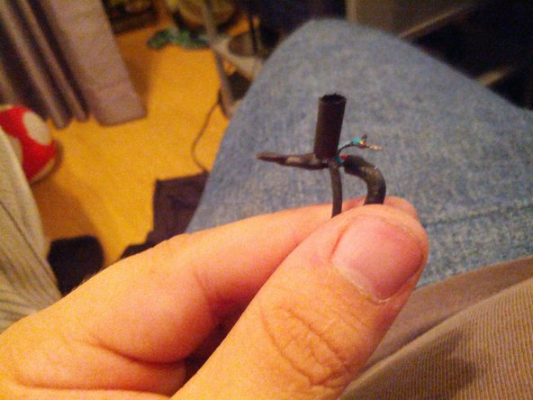

  • once it works properly
  • put the 2 cables paralel to each other and one of the wires down make sure its not touching any other exposed wire
  • wrap electrical tape around once
  • put a second wire down wrap it a second time with tape
  • bend one of the cables to face the other direction and the last wire down
  • wrap it 3-4 more times to make it sealed well or use heat shrink tubeing if you have it
