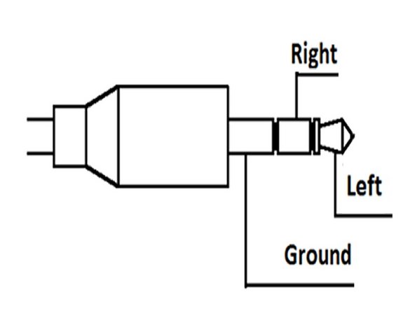

  • do the same to the patch cable if it has rubber sheleding just strip off about 0.25"
  • to find the right wires (color codes are different depending on the manufacturer):
  • take a multimeter and set it to resistance (or contanuity if you have a fancy one)
  • put one probe on the sleeve(the biggest part of of the 3.5 mm plug (the ground) and try each wire in turn with the other probe to find it
  • next repeat the process with the tip of the plug (the left channel)
  • the last wire (if you have 3) will be the right channel
  • you may have a 4th wire this is a seccond ground wire
