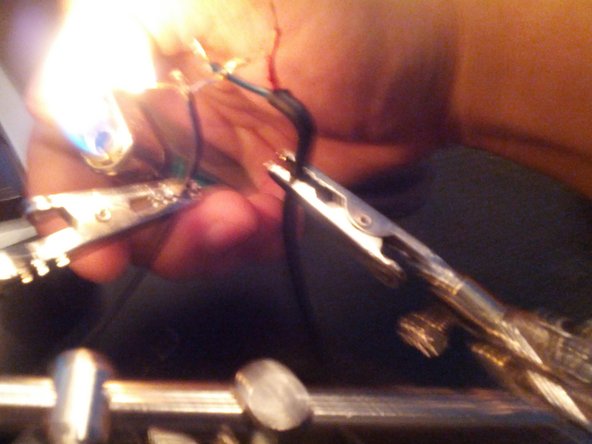

  • strip the wire from where you cut it .5-1 inch should work fine the couler codeing on the wire is as follows
  • red=left ear cup
  • blue= right ear cup
  • copper/gold= ground
  • the wires are clear coated so carefully use your lighter to burn the ends of the exposed wire
