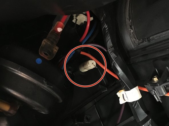

Blend Door Alignment
  • There's a good chance that the orientation of the blend door will not match that of the new actuator you bought. Since it isn't possible to rotate the servo without supplying a signal to it, you'll have to move the blend door to line up with the servo.
  • The white post is what the actuator turns. You should be able to turn this by hand to line up with your new actuator.
  • Now reinstall the new actuator, don't forget to connect the electrical connector.
