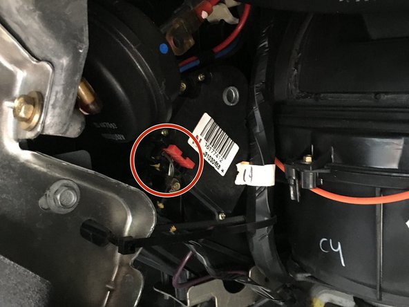

Actuator Electrical Connection
  • There is a 4-pin cable connecting to the bottom-left of the actuator. There is a tab that can be pressed to release the cable from the actuator.
