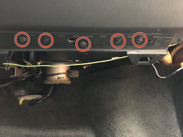

Glove Compartment Door Hinge
  • Removing the kick panel should have exposed the hinge for the glove compartment door.
  • There are five 7mm hex head screws holding this hinge to the dashboard, remove them.
