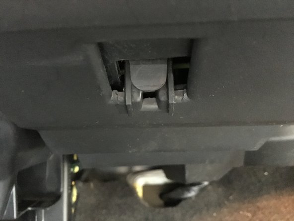

Passenger Side Kick Panel (Continued)
  • Remove the clips on each side, this can be done by pushing the exposed tab forward.
  • The kick panel should now fall down.
  • Don't pull the panel out just yet, there's still a courtesy light that is mounted on the panel and connected with a wire.
