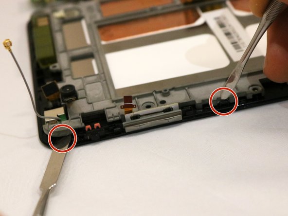

  • Now you will be free to detach the screen from the front cover.
  • With the device face down, pull up on the top left side of the metal frame while pushing out the plastic tooth using two spudgers.
  • Gently lift until you feel the tension of the adhesive on the right side.
  • Once you feel tension, slide a spudger tool down the length of the right side to remove the adhesive.
  • Be sure to move the tool straight down the side. There is a thin copper film that can be crumpled if the spudger enters from the side.
