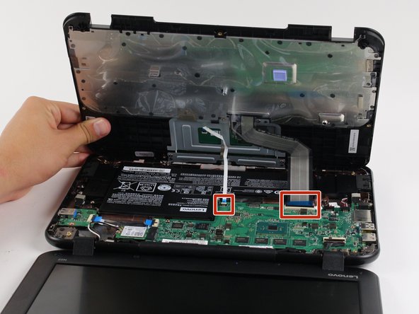

  • Once the keyboard is released, grab the two top corners closest to the screen and slowly lift the keyboard up.
  • Do not lift the keyboard quickly or you might break the two cables that connect the keyboard to the motherboard.
  • Disconnect the cables by lifting up the retaining flaps on the black ZIF connectors.
  • Slowly pull the cables up and out of the connectors.
