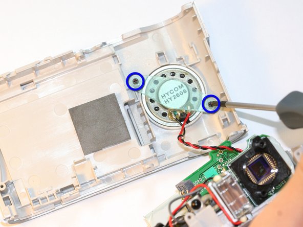

  • Use the #00 Phillips screwdriver to unscrew the two black speaker screws.
  • Lift off plastic cover.
