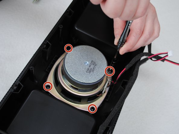

  • Using a Phillips #1 screwdriver, remove the four 1.2 cm pan head screws surrounding the speaker.
