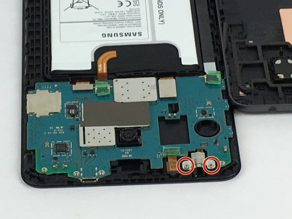

  • Remove the two Phillips head screws attaching the auxiliary port to the plastic frame using a P000 screwdriver.
  • Remove the four Phillips head screws attaching the motherboard to the plastic case using a P000 screwdriver.
