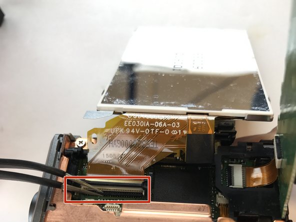

  • Turn the LCD screen over to the side exposing the connection to the motherboard.
  • Remove the display data cable connecting the LCD screen to the motherboard. Using tweezers, pry up the black retaining flap then gently pull the display data cable free.
  • Be careful when handling any display data cables in the camera as they are prone to tearing.
  • To close for reassembly, slide the display data cable back into the ZIF connector and close the retaining flap.
