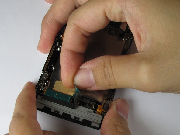

  • Peel off the gold and green tape near the bottom of the phone.
  • Peel off the blue tape covering the speaker connector.
  • Peel off the gold tape to the left of the earpiece speaker.
  • It is unnecessary to remove the blue and gold tape from the device if the speaker is not being removed.
