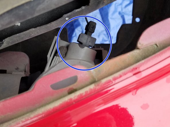

  • Now as you remove the front bumper, be sure to only pull it off far enough to reach down and unplug the wires to the passenger and driver side blinkers and running lights. Alternatively to freeing the wire, the bulb and wire harness may both be freed by twisting counterclockwise. Once everything is unplugged, pull gently until the bumper is free.
  • If there is any significant resistance when trying to free the bumper, then check to see if any bolts or wire connections have been missed to prevent damages.
  • It is optional to place the removed bumper on a blanket to prevent damage.
