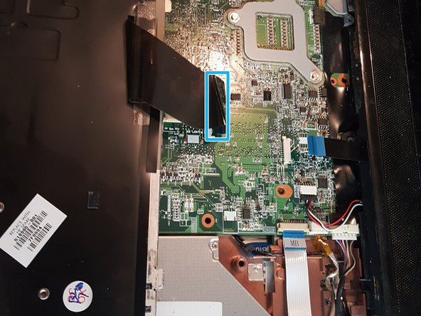

Ribbon cable/Keyboard removal
  • With the ribbon cable (in blue), gently lift the black bar holding the ribbon cable in place in the connector attached to the circuit board. Carefully slide it out, don't try to force it, and you should be able to pull the keyboard out of the laptop at this point.
  • Congratulations! You're over the hill at this point, get yourself a cookie and glass of milk.
