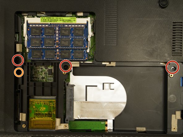

  • Remove three (3) 5mm x 4mm screws with the size 0 Phillips head screwdriver.
  • Remove one (1) 4mm x 4mm (closest to the battery) screw with the size 0 Phillips head screwdriver.
