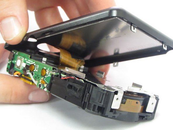

  • The last part of the casing to disconnect is the back that houses the LCD screen.
  • The screen is attached by a connection ribbon. Gently pull the casing and screen away from the camera body to disconnect the casing.
  • The LCD screen is held onto the back casing by a small amount of adhesive. This may come loose during this process. Do not worry if they become separated.
  • This plug and the connection ribbon are fragile, try not to tear the connection ribbon when disconnecting.
